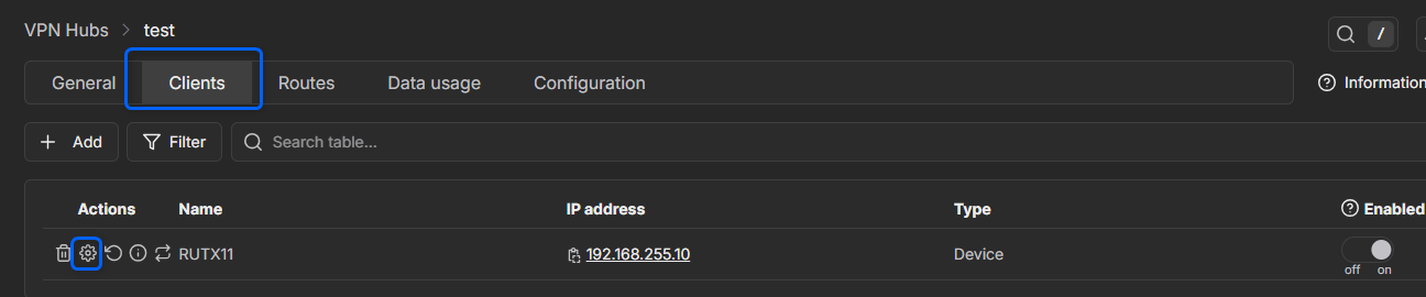

If understood correctly, you need to set a Static IP address for your device in the RMS VPN Hub, so it doesn’t change after each restart.

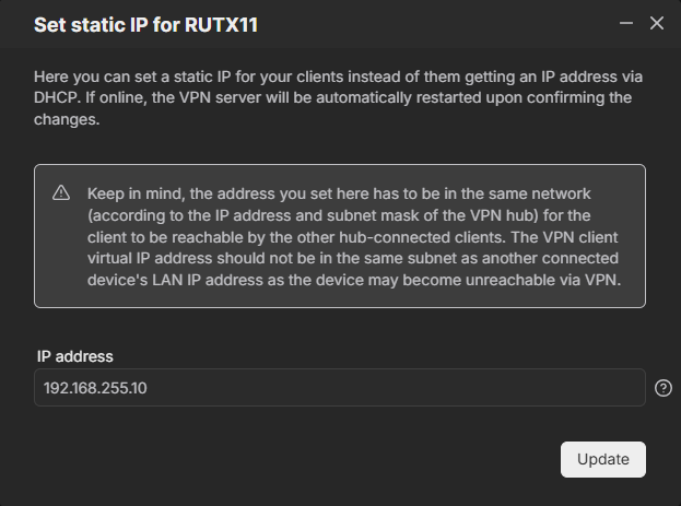

This can be done by going into the RMS VPN Hub settings → Clients tab → Pressing on the little cog wheel besides your device → Then setting the static IP address for the device and saving the changes.
Thank you very much for the super quick response!
OK, I was unsure whether the static IP would mess up the VPN hub. I will therefore set the previously automatically assigned addresses as static.
