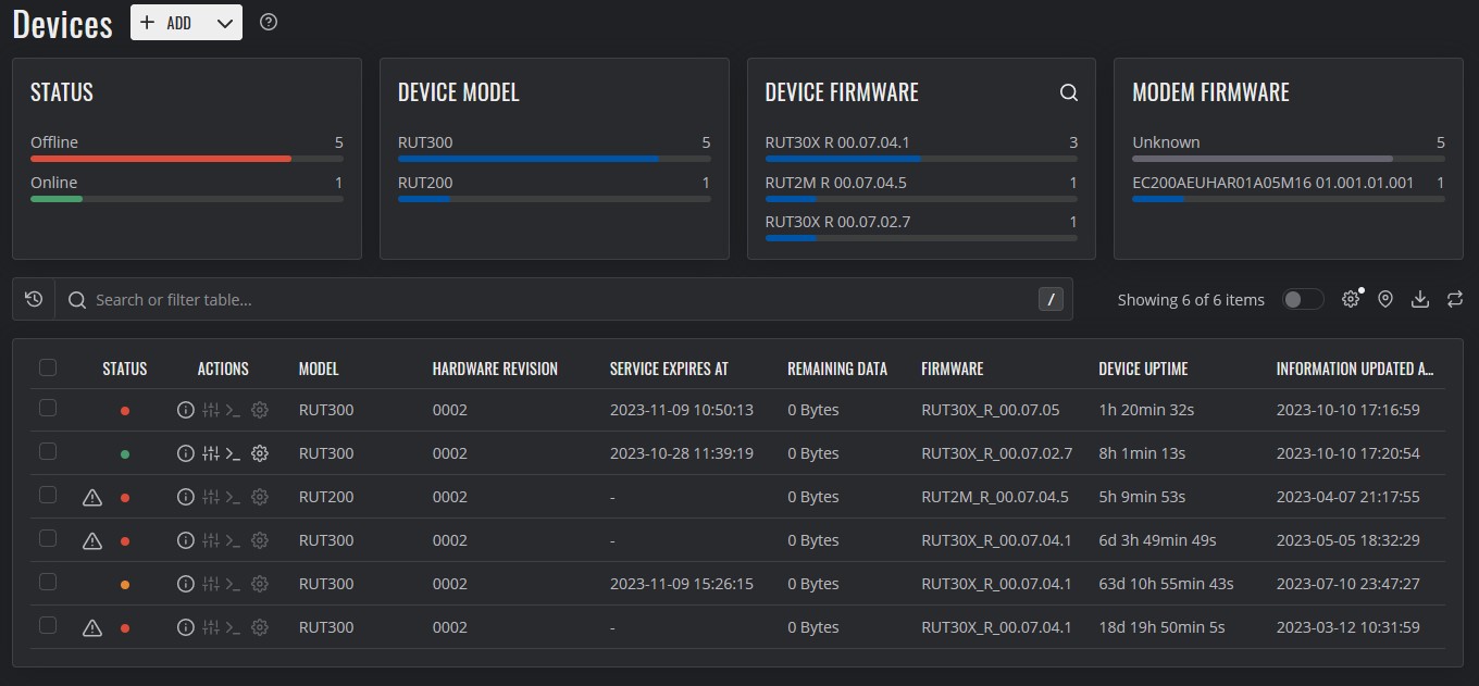

I have a couple of RUT300 where the firmware is 7.04.1 and they are not accessible via RMS, but I have one RUT300 with 7.02.7 which is fine and accessible via RMS.
Please advice, either how to downgrade without PC/GUI, or why RUT300 with firmware above ver. 7.02.7 is loosing RMS connection.
Since neither the newest firmware, nor the latest firmware used in production, I will ask you to update the devices that are on 07.04.1 to 07.04.5 or 07.05 and check if the issue replicates. If it does, please attach a screenshot from the router RMS page, where the error could be seen.

I’ve found the RMS offline problem with RUT300 and new firmware’s.
It looks like, once you unregistered device from RMS, and add it one more time it will connect to RMS only on firmware 7.02.7
It will stay offline on firmware’s 7.03 and above.
It seems there’s a glitch in RMS server - please correct it.
