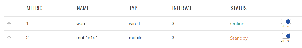

Hi! How I can manually failover to other multiwan interface?

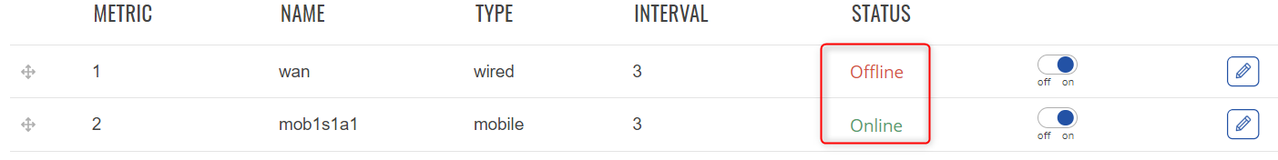

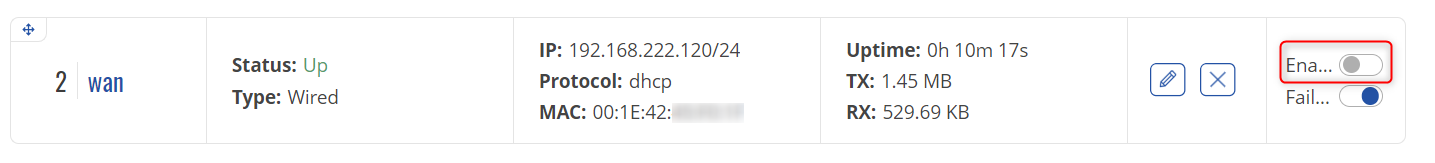

If you have failover configured, you can disable the interface in Network → WAN and the device should switch to the backup interface.
Or switch the order of the interfaces in Network → Failover so that the interface that you want to be active is at the top of the list.
