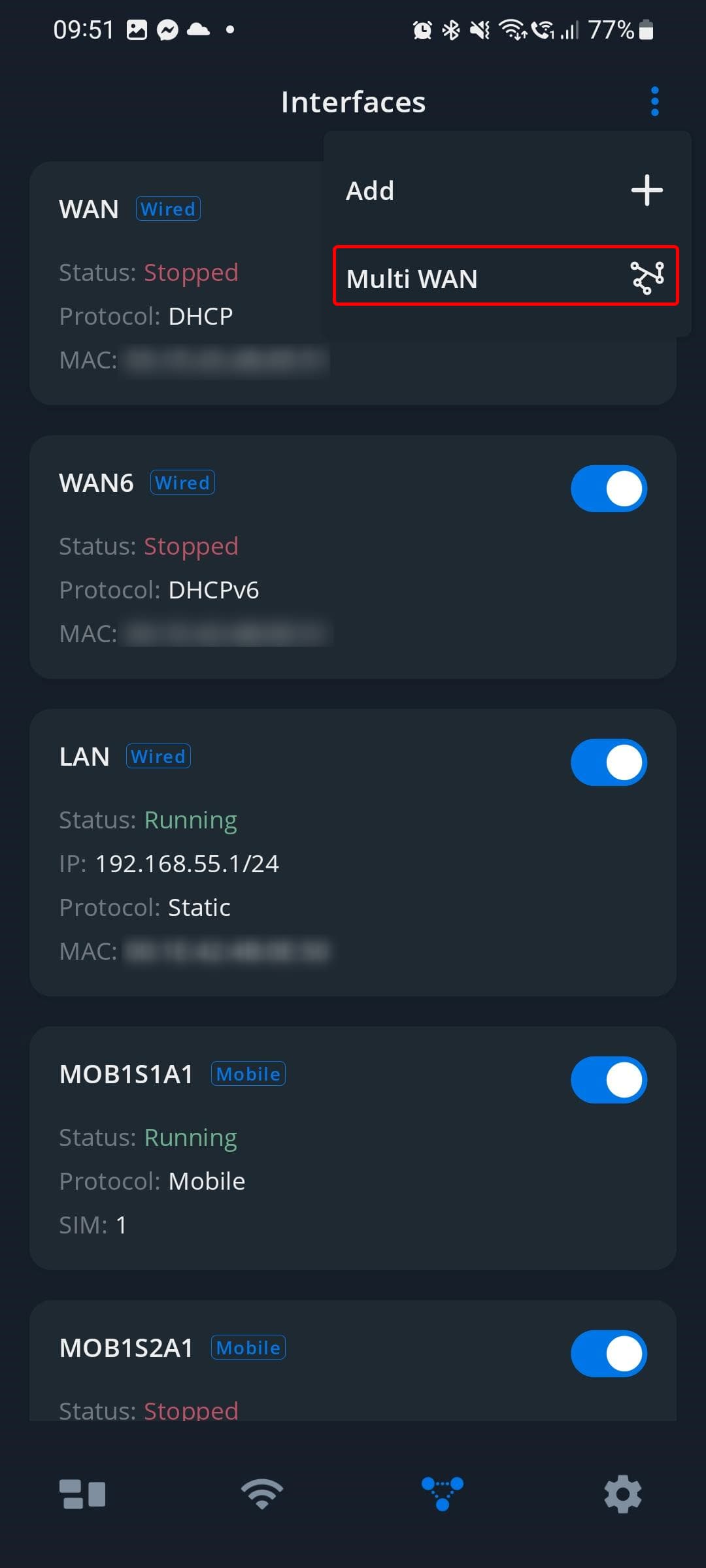

Since the new settings the RUTOS App don’t show me the three points on Interfaces. There is only a “+”. And no menu with “Multi WAN”. You know why?
Thank!
I suggest using the Web interface for more advanced configurations, as the app is mainly meant for monitoring and minor adjustments.
However, I’ve checked, and it seems like it’s still available on the latest Android app:
Try updating the app and check if the issue is still present.
