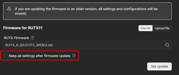

There’s no actual button for factory resetting from RMS without logging into the WebUI, however, there is a workaround that you could do, which would be upgrading the device firmware without keeping the device settings:
This would basically erase all the configurations and would also perform a firmware update/reflash/downgrade (whatever firmware version you currently have, and whatever firmware version you’re going for).
That is a neat idea, I’ll take that as a solution.
