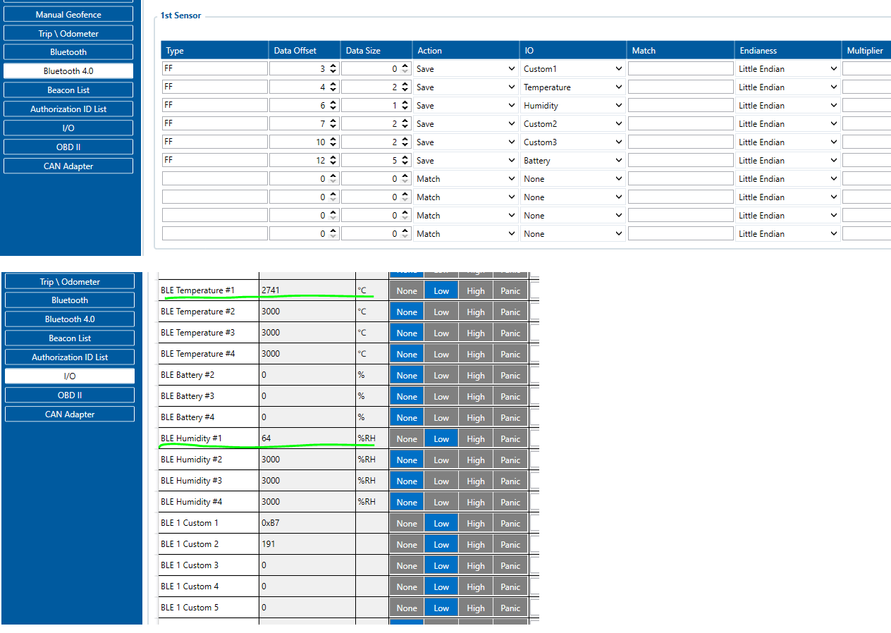

Hello! How do i read the magnetic data from EYE SENSOR through the configurator I/O with my FMB130?
I can only receive Temperature and humidity data but not the magnetic ones.

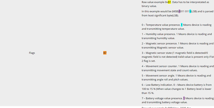

Hello There,
magnetic detection is available on BLE 1 Custom 1. To read that value, you can follow the documentation on Teltonika Wiki relating to the flag value EYE SENSOR / BTSMP1 - Wiki Knowledge Base | Teltonika GPS.
