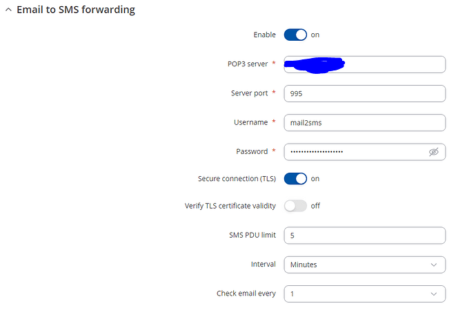

I have tested Email to SMS forwarding using the Gmail server on RutOS 7.13.1 firmware, and everything works as expected. Could you please share the screenshots of your configuration (make sure to hide any sensitive information)? Also, please let me know which mail server you are using.

Thanks, I just filled out the form! Looking forward to hearing from you.
