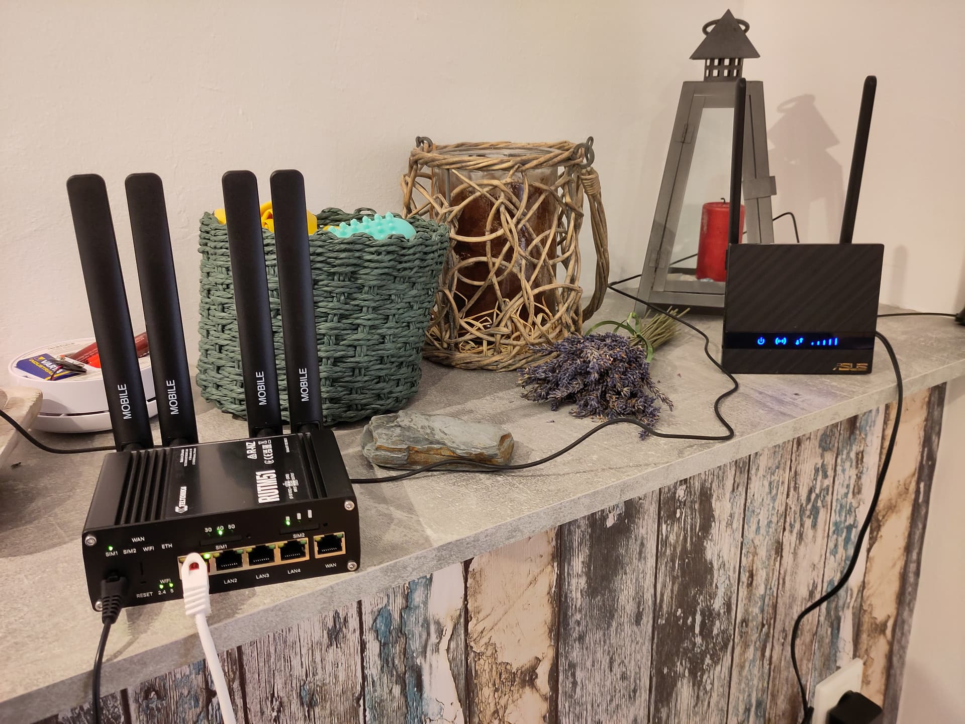

What I just don’t understand is why, after 4 months, there are suddenly these abrupt reception drops while surfing. At least 4G should allow smooth reception. I take my cheap ASUS 4G LTE router from the motorhome, insert the SIM card from the RUT into it, place it next to the RUT, and have flawless, continuous 4G reception for hours—that’s what I don’t understand. Is the RUT defective?

I am sending the current event logs and a photo showing the cheap ASUS (4G)router next to the RUTM51 with full signal strength. On the RUTM%1, I have disabled IPv6 and enabled ping reconnect. All without success. The router suddenly fails, the download speed drops. Even during the speed test, it regularly disconnects because it loses the connection to the Telekom server. Regards Juergen

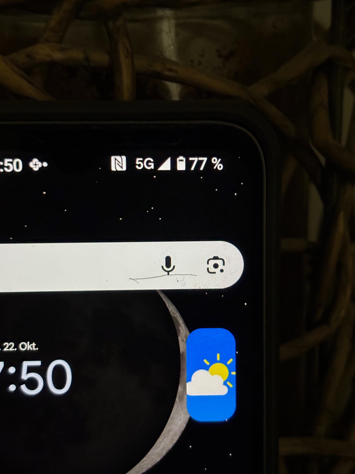

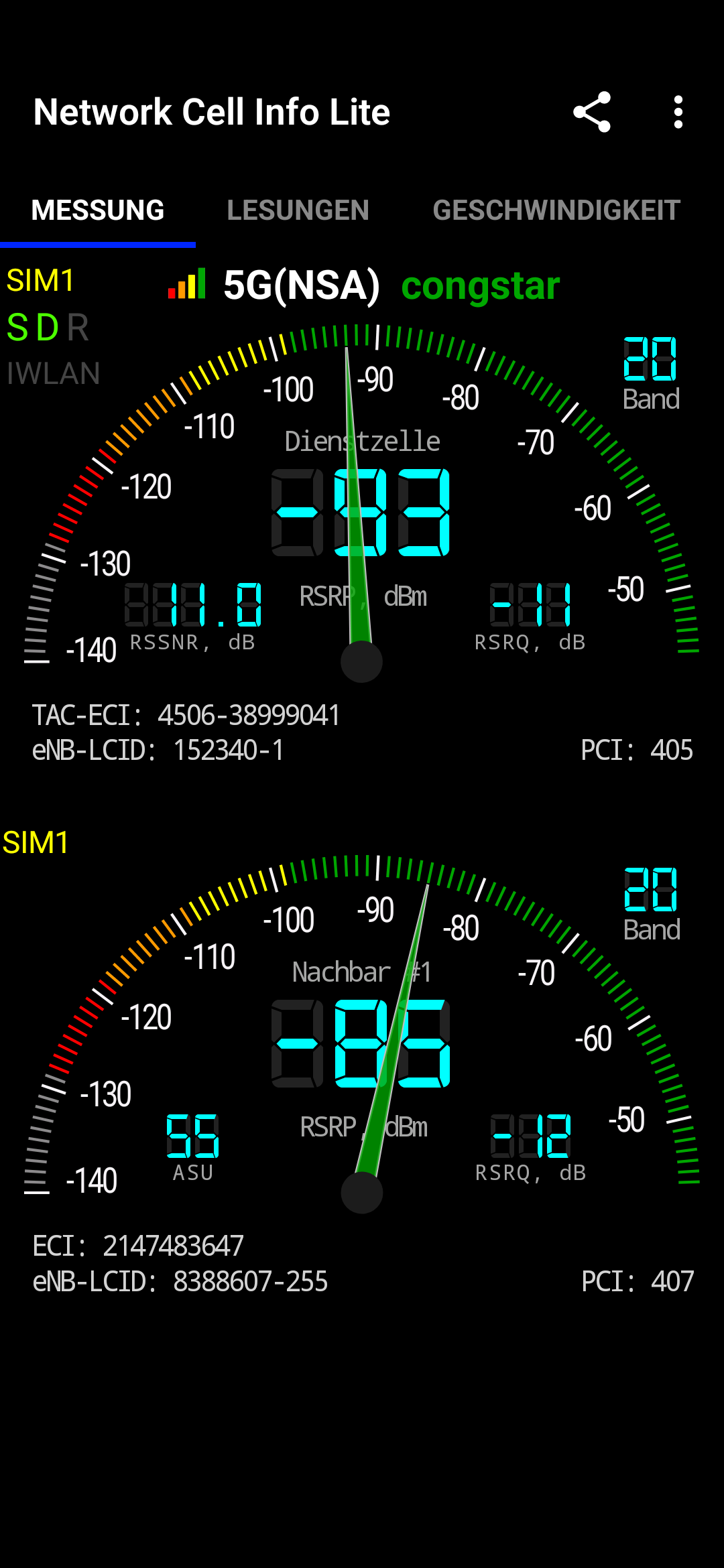

My Handy with full 5G and the result of a measurement.
