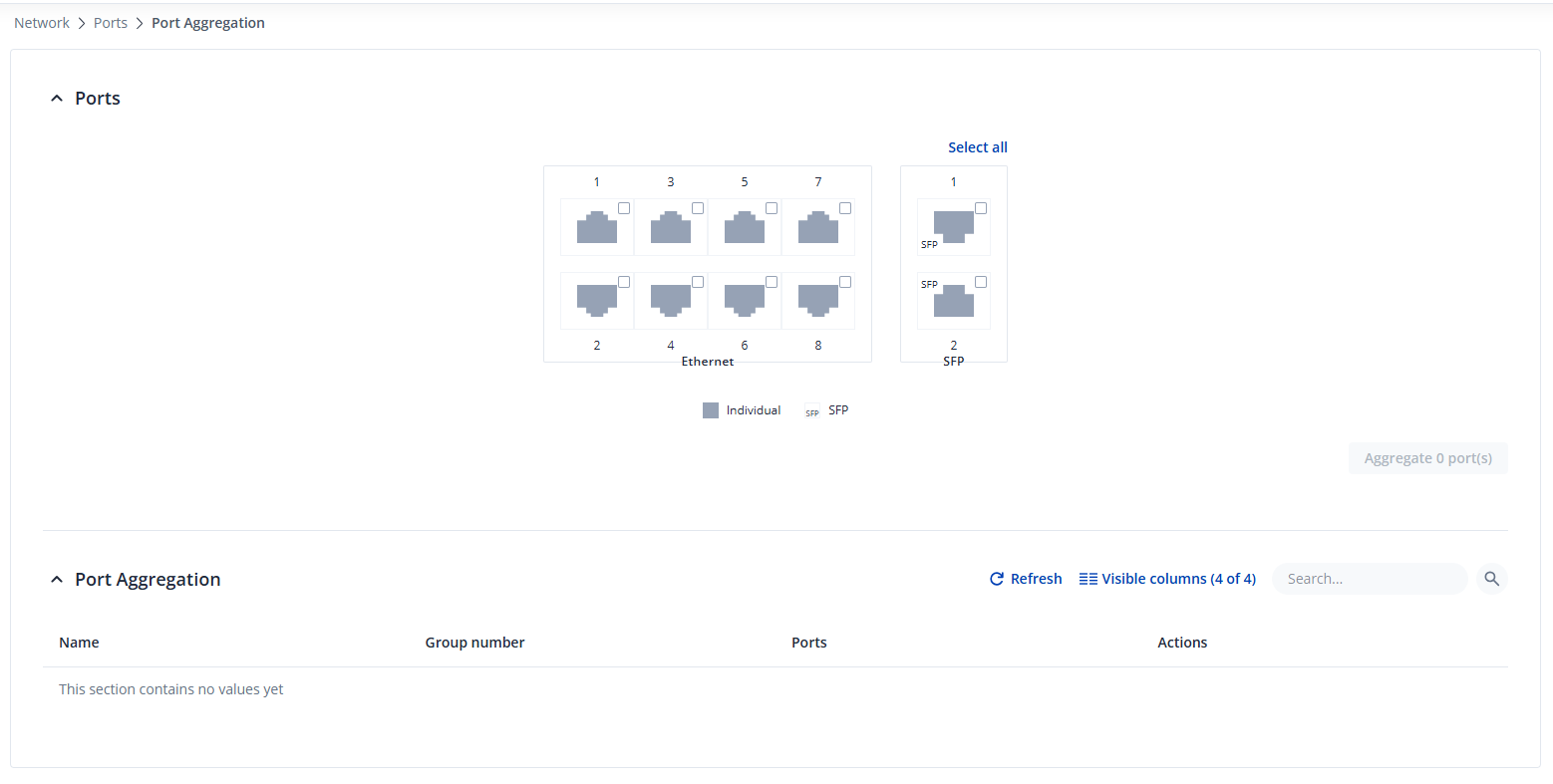

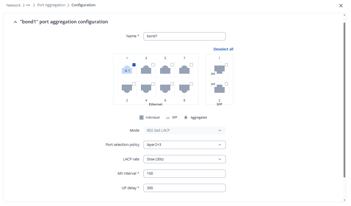

I just got the confirmation - yes, LACP is supported, and is called Port Aggregation.
We’ll update the Wiki accordingly for future reference, thank you for letting us know.
