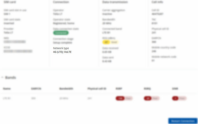

Could you check in the Status → Network → Mobile page if VoLTE is active?
If yes, then could you clarify if both RUT200 and RUT901 uses Quectel EC200A modem (can be found in Status → System)?
