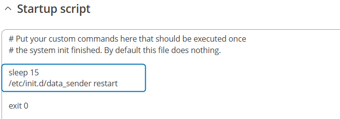

Apologies for the delay, and thank you for your patience. This issue has already been identified by our R&D team and is expected to be resolved in the upcoming RutOS 7.14 firmware release soon.
In the meantime, as a temporary workaround, you can delay and restart the data_sender service by adding the following commands to the custom startup script (found under System → Maintenance → Custom Scripts page):
sleep 15
/etc/init.d/data_sender restart
