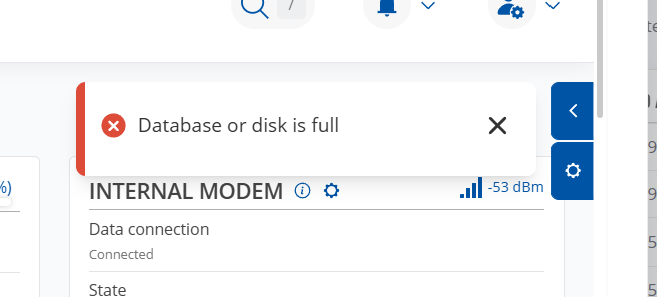

I get this recurrent message from my router that I have a full disk or database which I can’t seem to shake. I have searched the system but I can’t find a way to purge or clean any disk or database. Someone knows what to do with this?

If these steps do not resolve the issue, could you please provide a screenshot of the error message you are receiving?
This is the message I get!
Could you confirm you’ve tried performing the suggested steps and rebooting the device?
