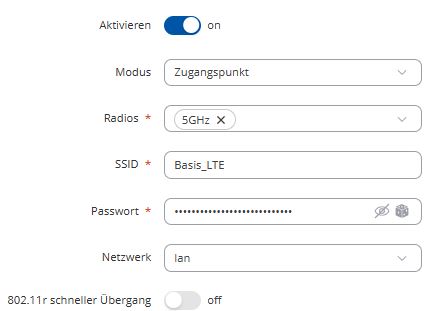

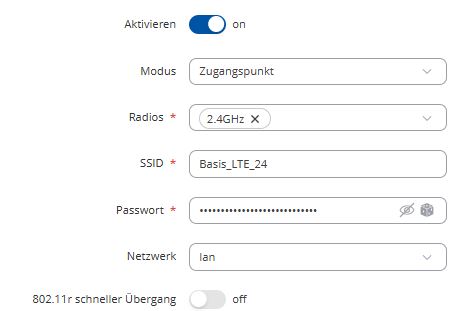

Renane the SSID at 2.4GHz to something_slow
rename the SSID at 5GH to something_fast
thank you.
hi.. its not a significant difference. But i saw that in SSID-definition
Network ist “LAN” - is this correct?
yes… BASIS only at 2.4GHz.
yes… Network it is LAN
and about 5GHz? Please… Can you test?
its very strange: 5 GHz is nearly down, the ookla-Site doesnt come up… :hushed_face:
