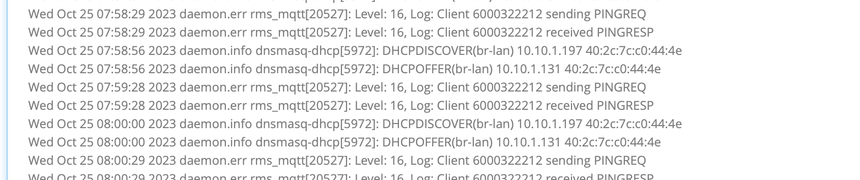

It seems that the end-device asks for the 10.10.1.197 address, but the router offers the 10.10.1.131 address. The device does not take it, and after some time asks for the old address again.

I also tried force giving it the old address, but it still does not show up. And the logs also show that that it asks for that address and gets it, but next steps don’t occur. It happened on a few devices, after the static ip is changed and the lease of the old address expired.

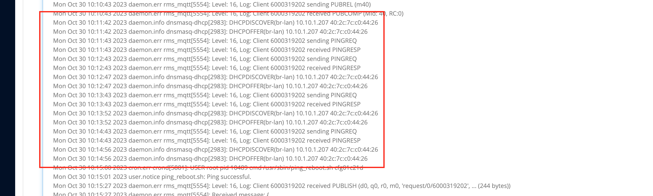

One other device, which got the Adress it was looking for, has the same Problem (see screenshot)
