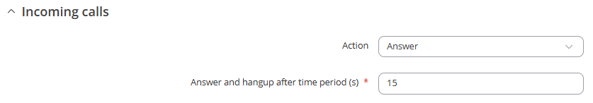

Additionally, if you want the TRB140 to accept incoming calls, you need to select the Answer action in Services → Mobile Utilities → Call Utilities:

Thanks for the information. I can now see the incoming calls.
