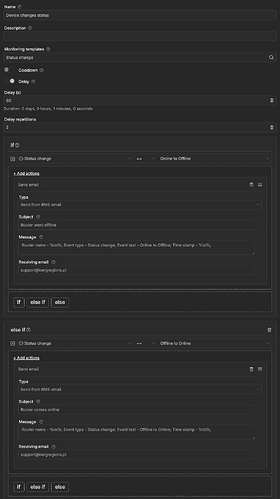

I’m currently using the status change alert as presented in attached screenshot.
I’d like to still receive them but if the router is offline for more than X minutes. Is it possible to setup?
I see the “Delay” parameter in which I can specify the time value but it also says: “…If the amount of triggers set in “Delay repetitions” occur in the time set in “Delay (s)”, then further actions and secondary conditions continue…“
So, can I use this parameter if I want to skip Online → Offline and Offline → Online notifications that happen within one-two minutes timespan?
If yes, what values should be set for this to properly work?

Hi Marija,
Using your solution I’ll receive a notification every five minutes if the device continues to be offline, right?
This is not my goal. I’d like to receive one notification if device stays offline for more than X minutes.
