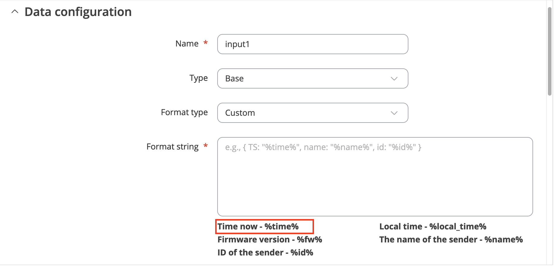

For timestamp you can use %time% in custom format type:

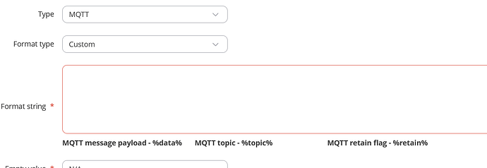

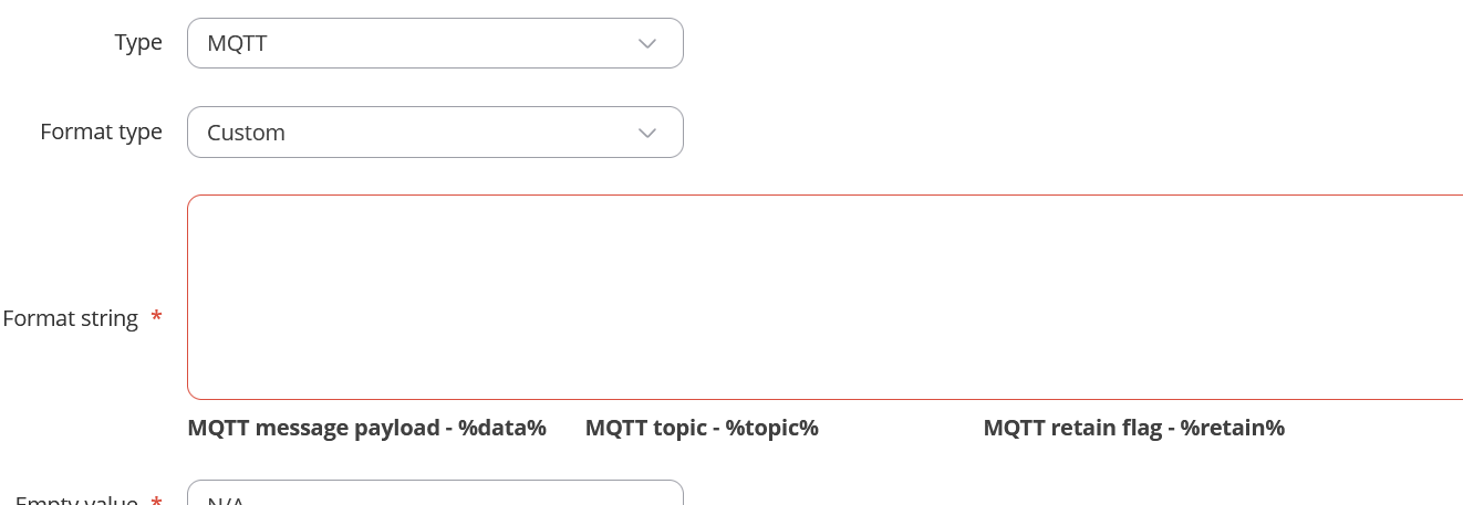

Unfortunately, but the %time% or %timestamp% value is not available for e.g. GSM or MQTT type. (which I care about)

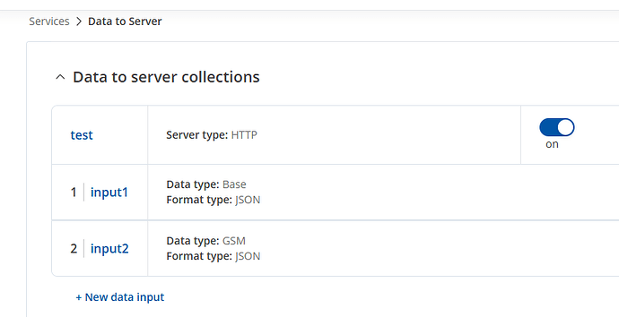

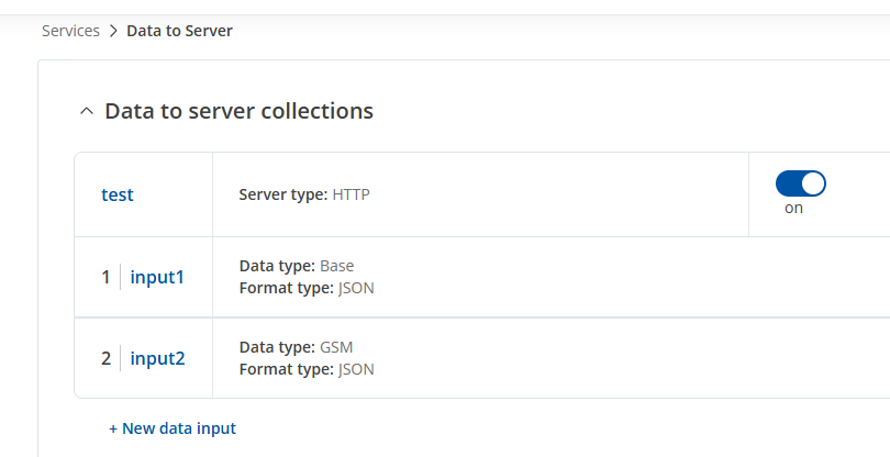

You should combine the two input sources to display the time (e.g., type Base has the %time% value, and you can combine it with GSM/MQTT). It should look something like this:
