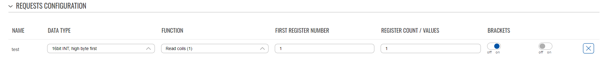

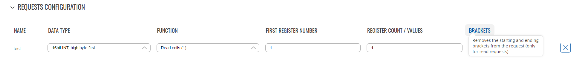

The brackets can be removed by enabling the Brackets option in the Modbus Master instance:
