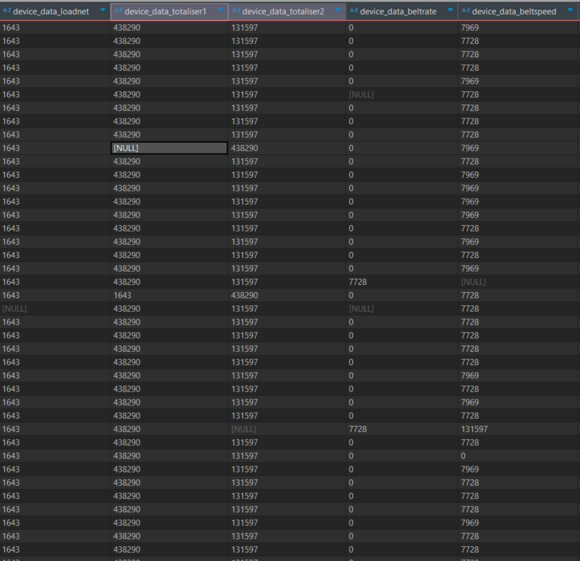

However I have an issue where if a modbus request fails the data to server would scramble the register data and their corresponding names, resulting in me getting the wrong data.
Below is a screenshot of how my data is being mixed up, you can clearly see the issue when looking at the totalisers:

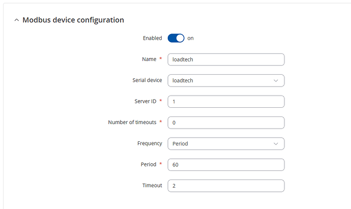

  1. Services → Modbus → Modbus Serial Client: The Modbus device configuration section.
  2. Services → Data to Server: The collection configuration section.

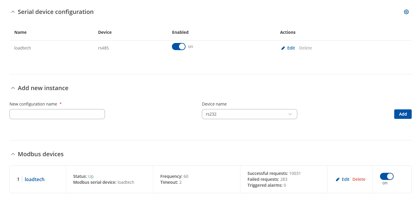

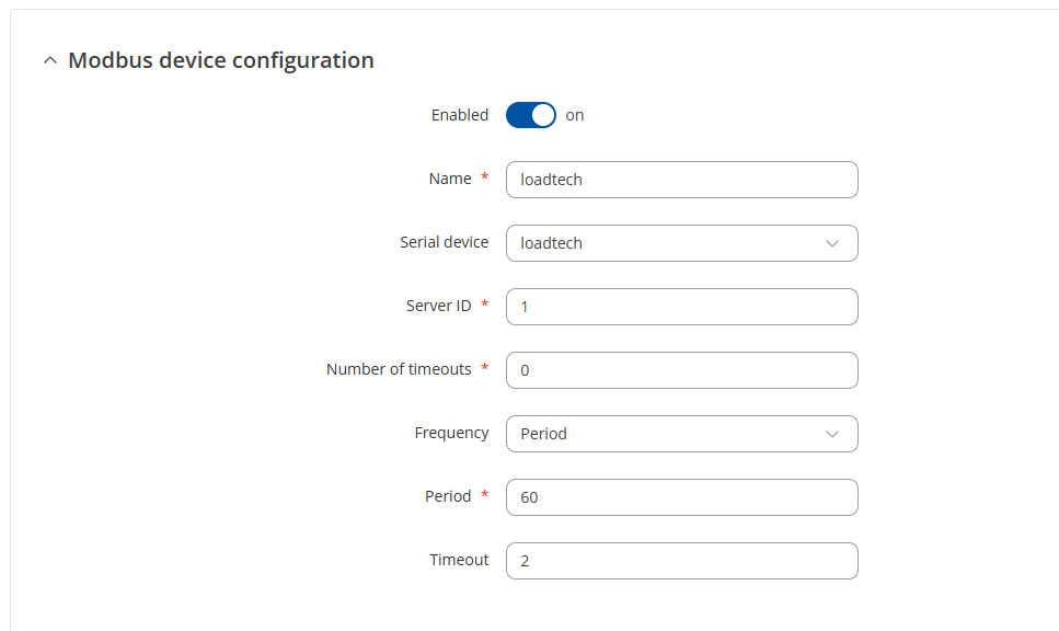

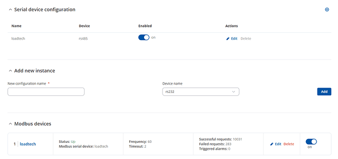

Here you can see that there are regular modbus timeouts which is fine, the main issue is how the data to server handles these timeouts.

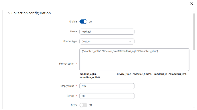

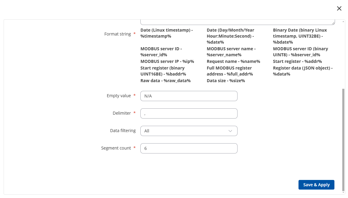

Here is the modbus configuration I use

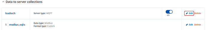

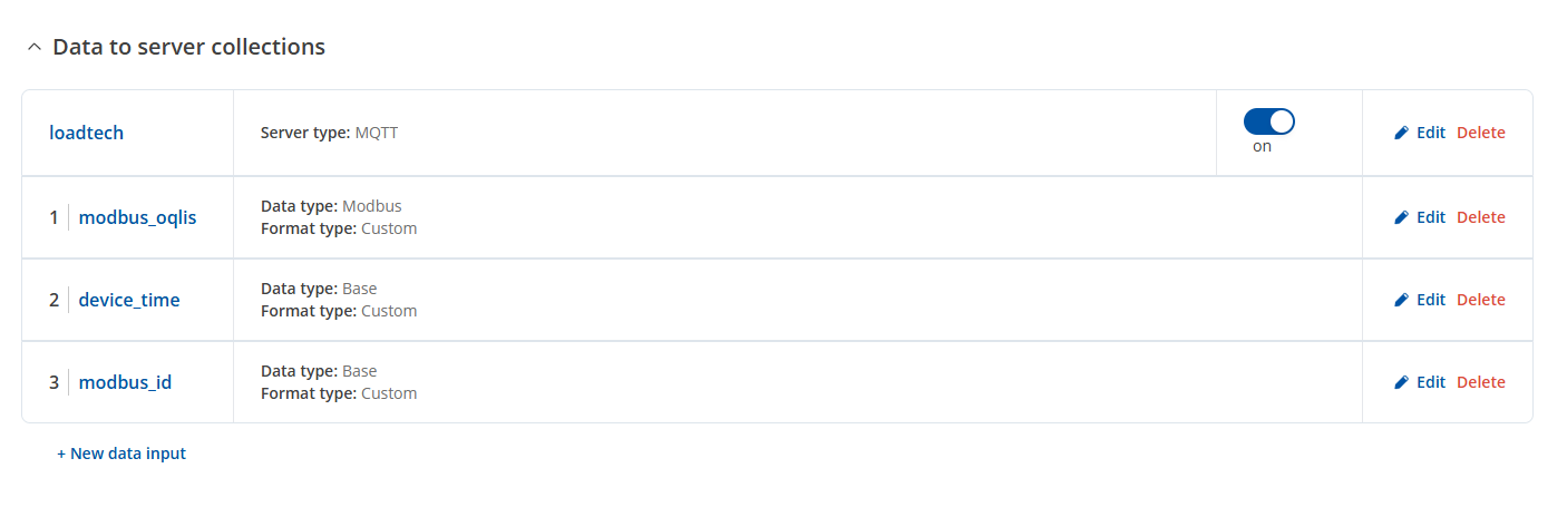

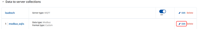

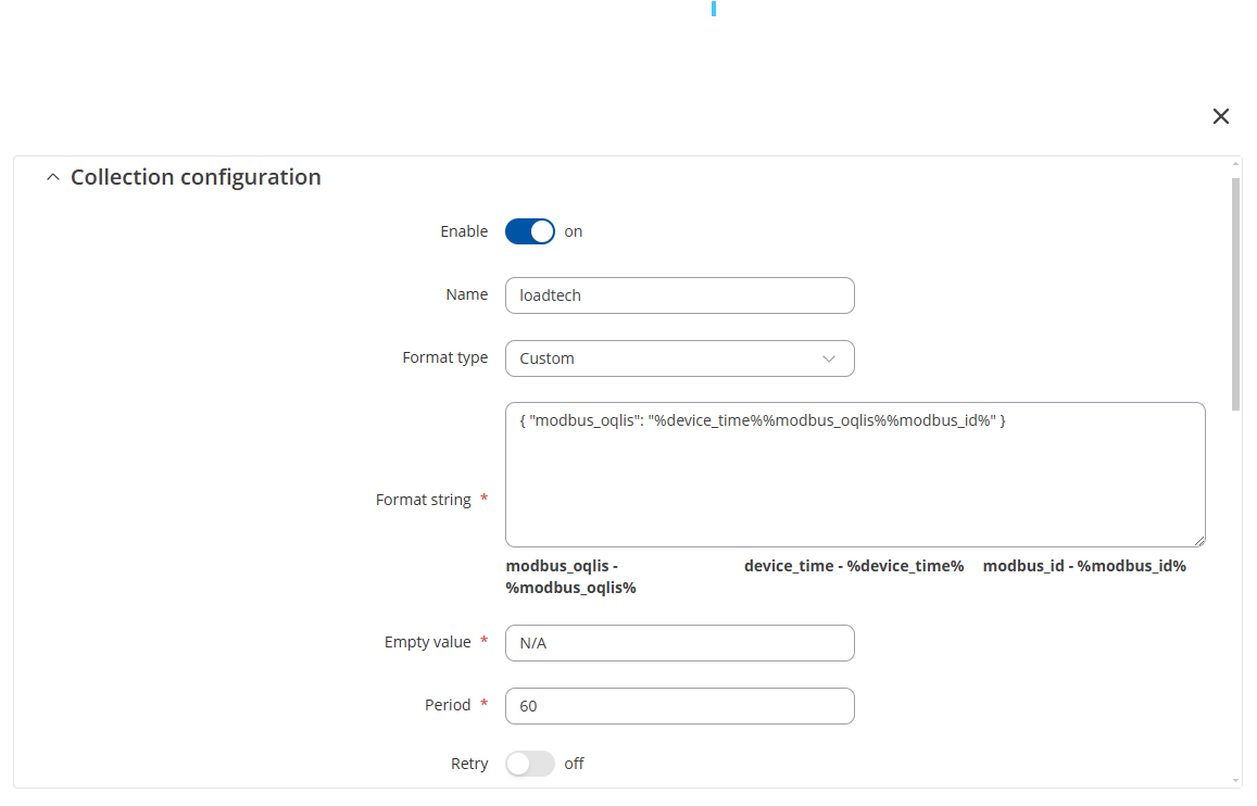

Here is the data collection configuration.
Also here I tried to have all the modbus registers send at the same time in hopes that the issue would be resolved, but im getting the same results. I originally had it to send one register at a time.

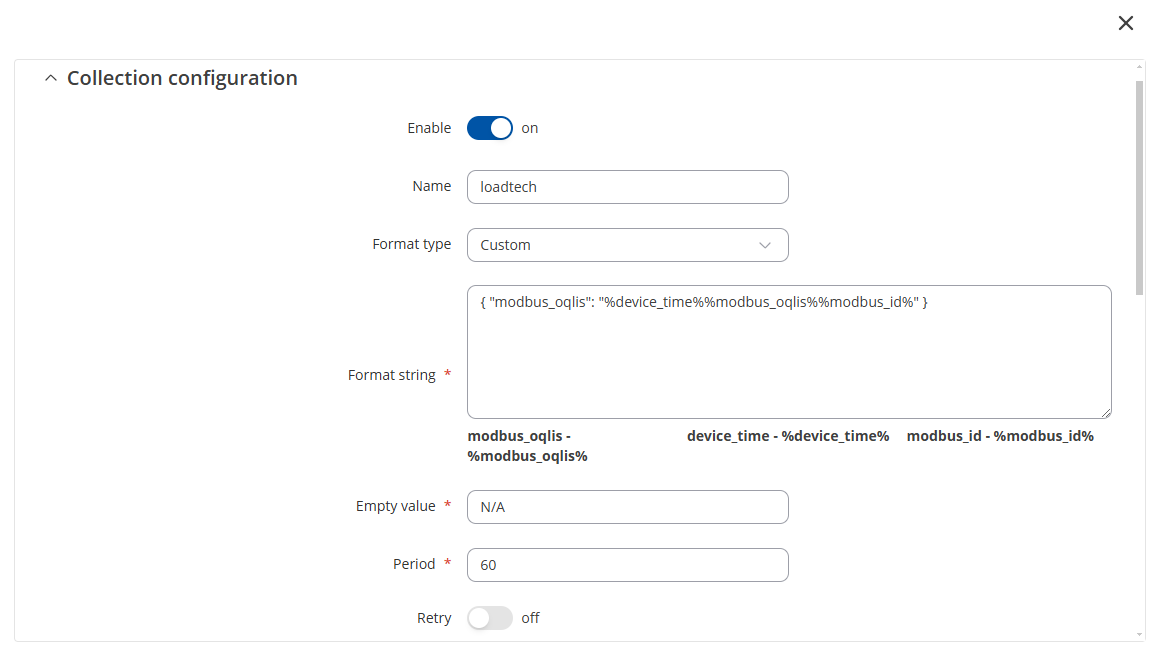

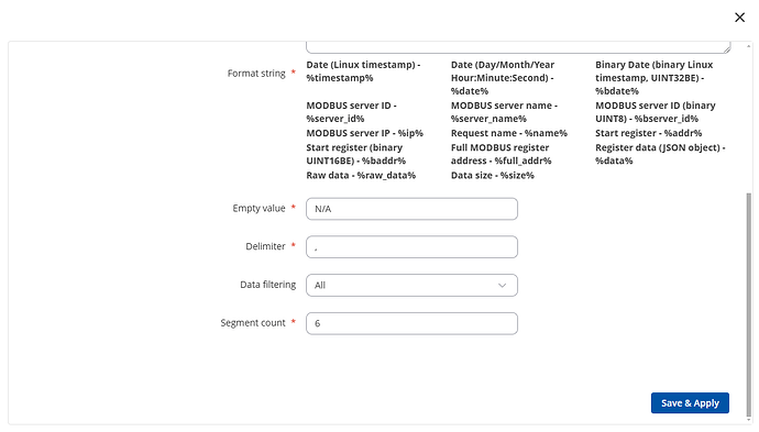

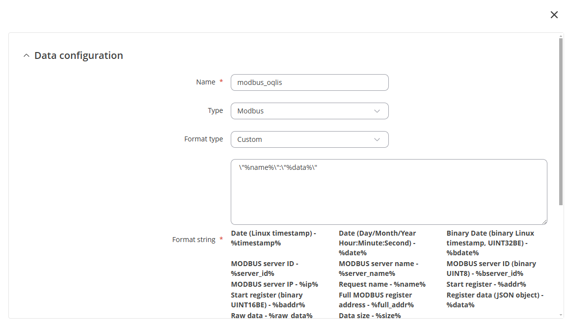

To further investigate, could you additionally provide a screenshot of the modbus_oqlis data configuration window?
Furthermore, have you noticed if this issue persists when the Modbus Serial Client Timeout value is set to the default of 1, or if it also occurs when adjusted to a higher value, such as 5?
Here is the data configuration:
I have tried it with different timeouts aswell. I also have a few other routers giving the same issue and they have a period of 10 and timeout of 1 or 2.

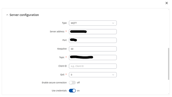

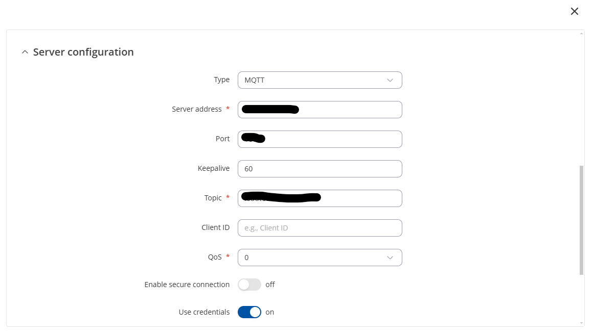

Additionally, please share a screenshot of your loadtech MQTT server configuration, ensuring any sensitive or private information is blurred out.
Thank you. Here is the MQTT server configuration:
