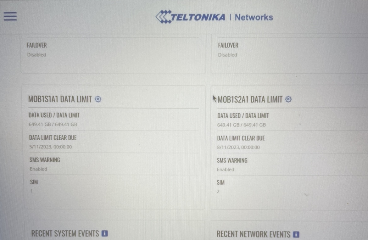

Please someone explain me why my router after I put data limit on both sim in the sim 1 happens something strange like if I used all the traffic in less then 1 hour?
When I set the data limit was 0 to 649gb now after some traffic is 649 to 649 and normally like this the router switch the Sim even if I don’t want because there is lot of traffic to be used.

After the upgrade the data limit show the same issue like before, data amount after a bit from 0/649gb go to 649/649gb
Same situation after a bit of traffic

About the data limit yes I have updated without keep setting but after more or less 10gb of traffic the counter show full data used

Regarding the data limit, I did some additional testing on my end with 7.04.5 firmware. I noticed that the overview page sometimes displays inaccurate mobile data limits, especially after changes or service restarts. However, a hard refresh (using Ctrl + F5 in Chrome) shows the correct data limits. Can you please try doing a hard refresh on the overview page multiple times and check if the displayed limit is accurate?
Tried to do what you told me but nothing change. Anyway i have upgraded the modem to the lastest firmware released this morning and now show the correct data for now, also the second sim is good now, before without using it show full data, now seems that it is correct and show N/A
