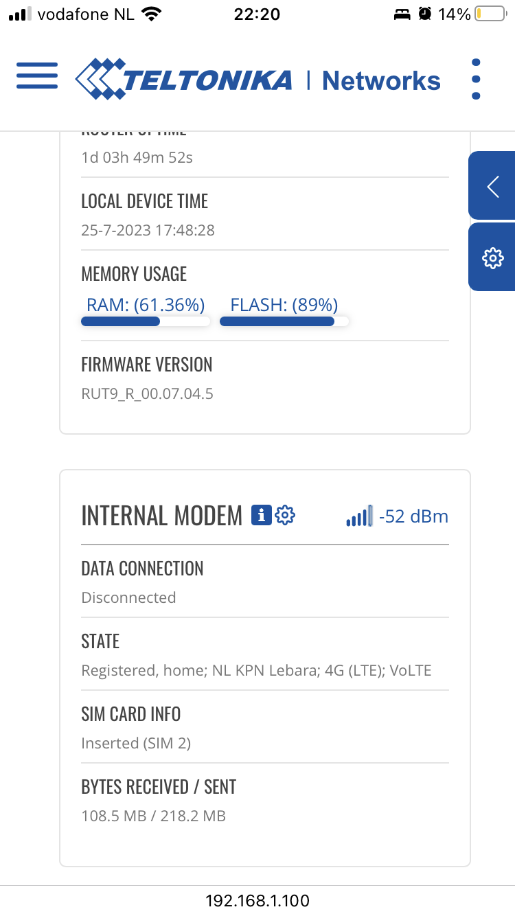

I have the same issue, (Data connection Disconnected).
But my issue isn’t solved yet.
After some startup problems with my RUT 955, it works fine for almost 2 years.
On my camper trip back from Kroatië to Slovenia, the 4G data just stopped.
It never gets on. Also not in Austria and Germany.
Reboot or my other SIM from my iPhone gave the same results!
router SIM in my phone works also fine.
Back in the Netherlands, still the same with both SIM’s!
also SIM swapped from slot 1 to slot 2.
After firmware update, also the same.
What is going wrong?
Please help to solve this
Thanks.

Thanks for your reply, but this hasn’t help me to solve my problem.
I partly agree with you. It cost me a lot of time but my problem is solved for now.
How:
  • I made a factory reset.
  • I load the latest firmware, what didn’t work, so first loaded old firmware (6.xx)
  • setting up data connection didn’t work.
  • Loading latest software firmware.
  • restore old settings was not possible (memory failure)
  • setting up all settings from scratch.
Finally that works.
But I still busy to set al other setting such as GPS, what’s going not so smoothly :frowning:
