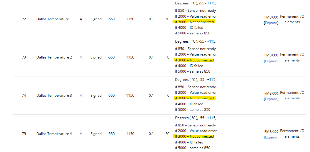

I hope you are doing well. It seems you are receiving an error code from the device related to the Sensor is not properly connected with FMC130. (see screenshot below)
Suggesting you to check on Wiring connection of Dallas Sensor with FMC130.

Actually I am not receiving error code. Indicated temperature is about 300 degrees (not 3000).
It seems like a ecoding problem. Even if I devide indicated valued by 16, still the result is not correct.
