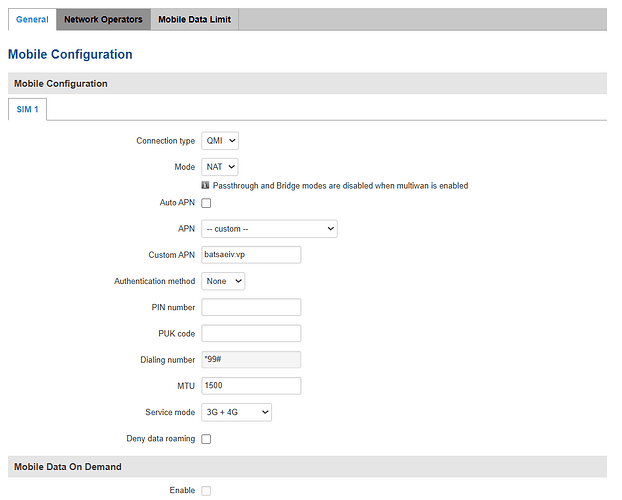

Could you please provide screenshots of the mobile connection configuration from RUT240, where the “m2m” Orange APN works properly?

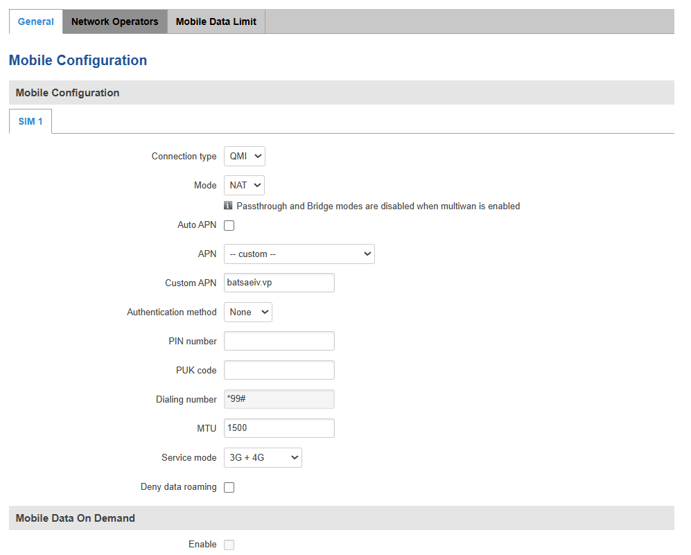

I try to add a new entry in the APN database but when I choise Auto APN, the ATRM50 router connects successfully but not on the wanted APN. Is possible to delete all entries in APN database in order to keep only my favorite APN ? Our APN name is “batsaeiv.vp” .

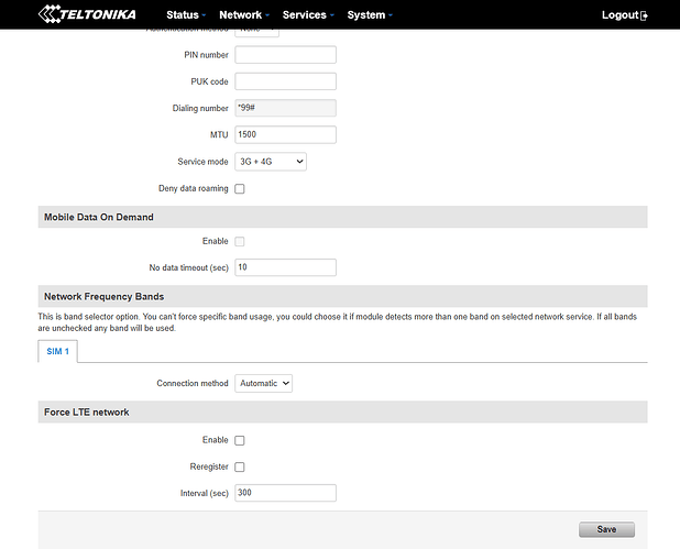

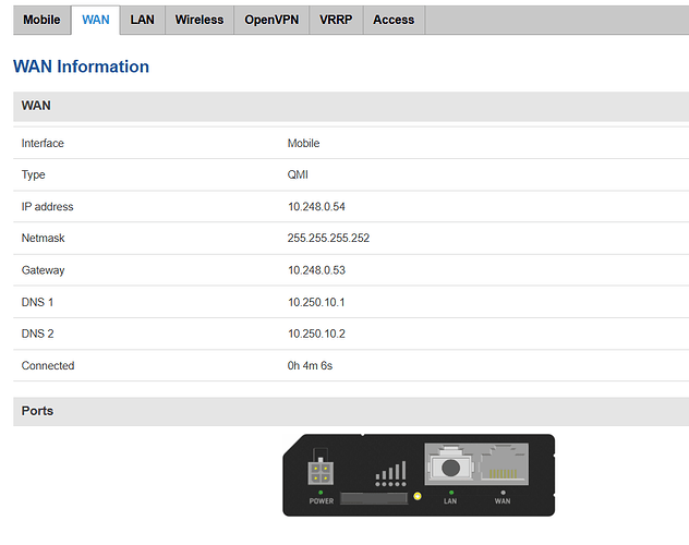

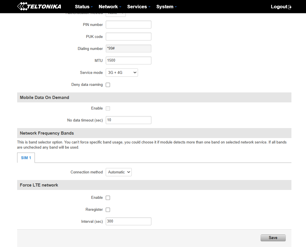

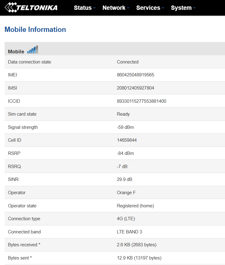

The RUT240 connects succesfully to the dedicated APN “batsaeiv.vp” with the choice of custom APN. Please see joined screenshots.
