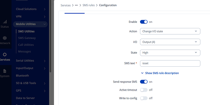

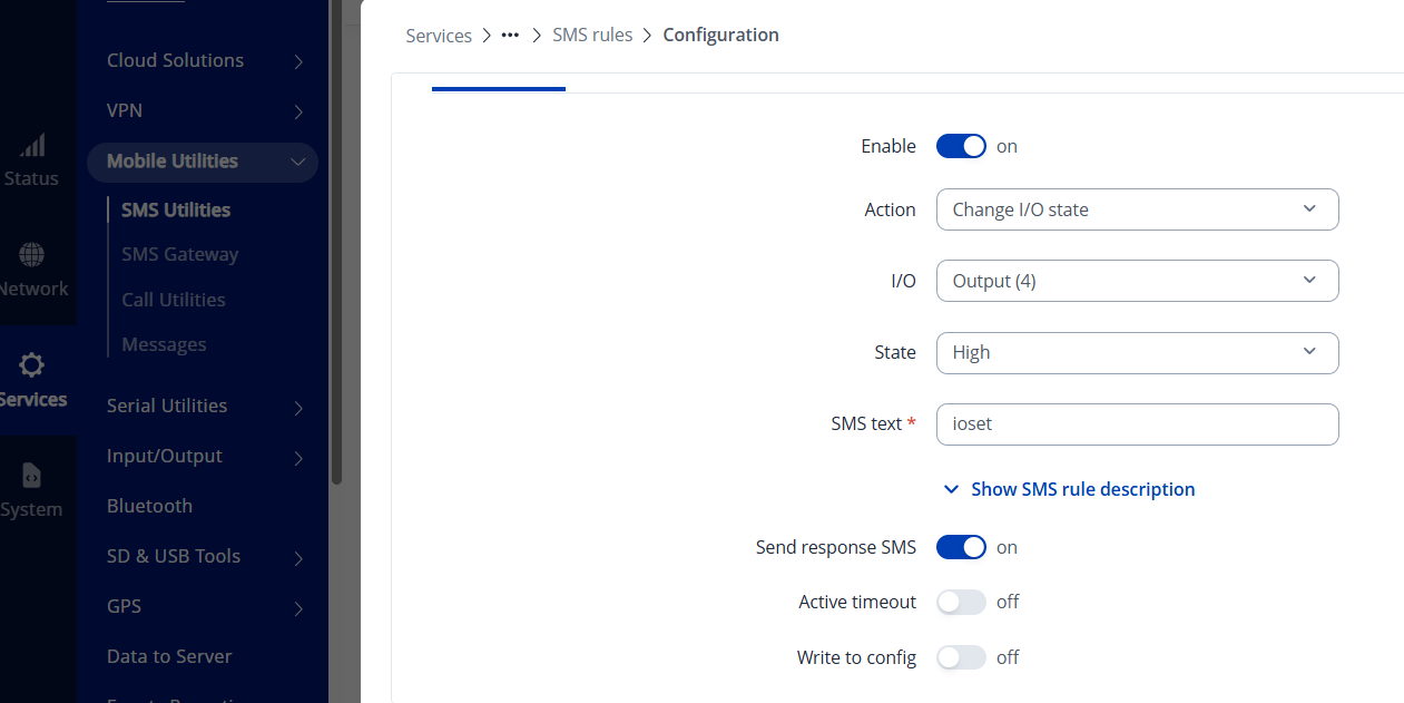

If MQTT does not suit your use case, you can also control the output remotely using SMS Utilities . In this case, you would configure the ioset command.
More information about SMS based control can be found here:
