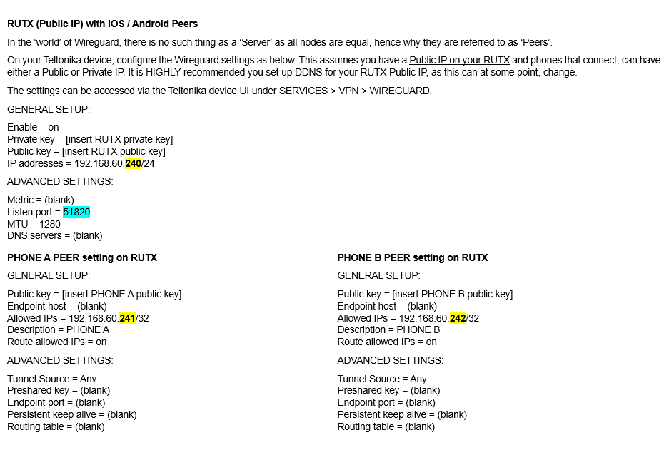

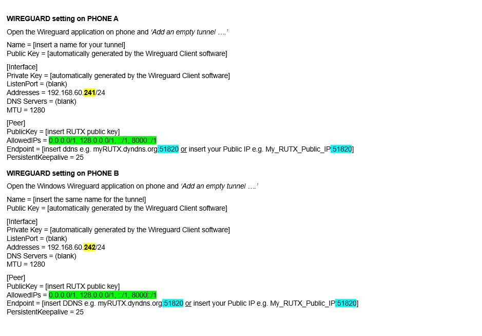

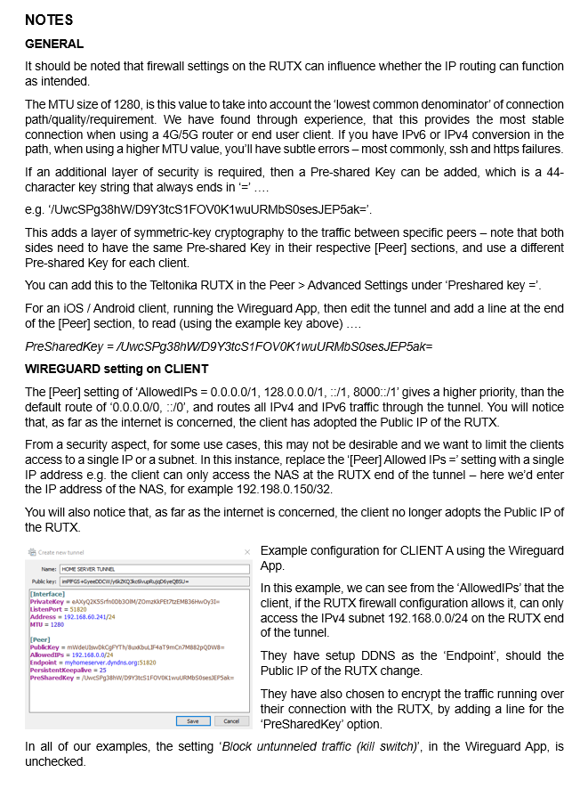

See example setup below …
It should be noted that your iphone / ipad may well not have a public IP. If this is the case, then your Apple devices will have to be the device(s) that initiate the tunnel connection and the RUTC will act as the responder.
