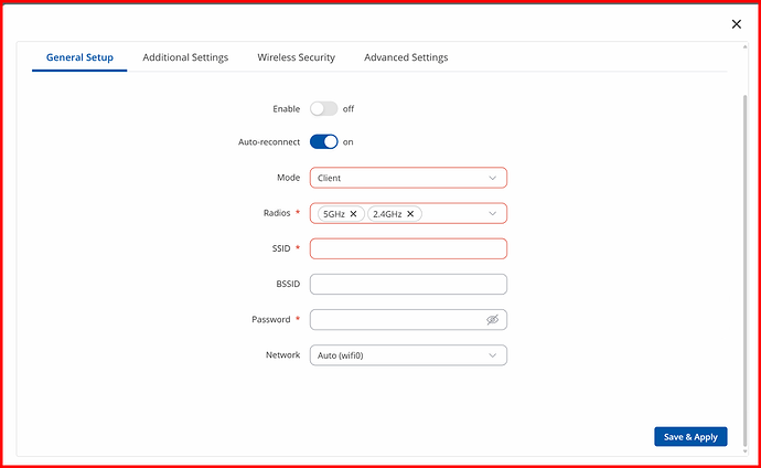

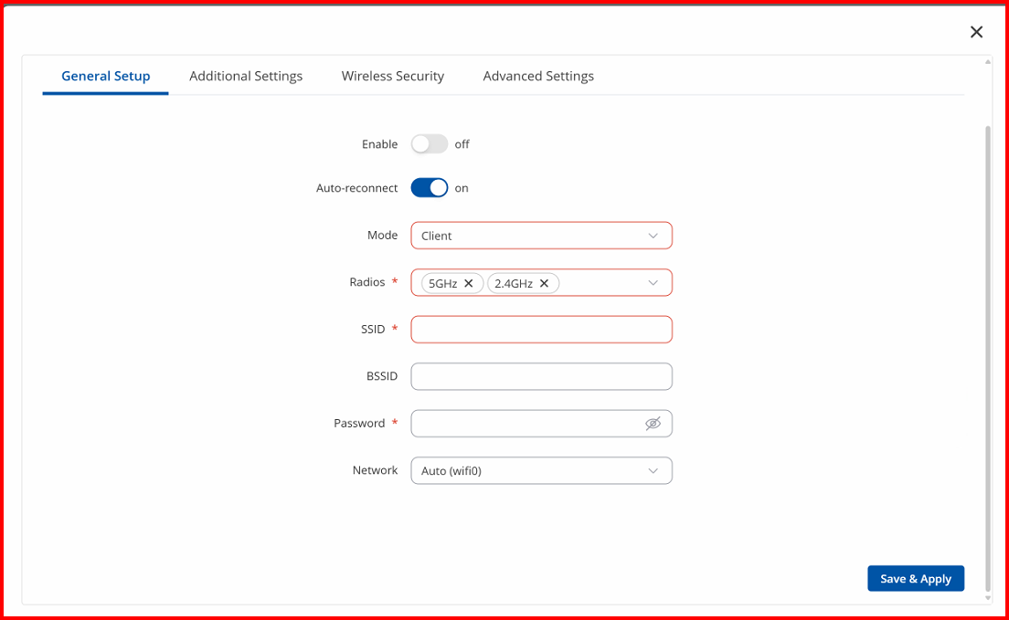

If I understand correctly, you should be able to enable the WiFi on the “RUTXBoat” to broadcast, and then in the “RUTXBase” you will need to add a WiFi Interface which then when configured will show up on the WAN interfaces page.
okay now the Second Router gives out internet and i am able to connect to devices that are connected to the main router with wire but im still getting a the ip address from the second router and not from the main router. i have a udp stream running on the main router and im not able to recieve it when im connected to the second router
