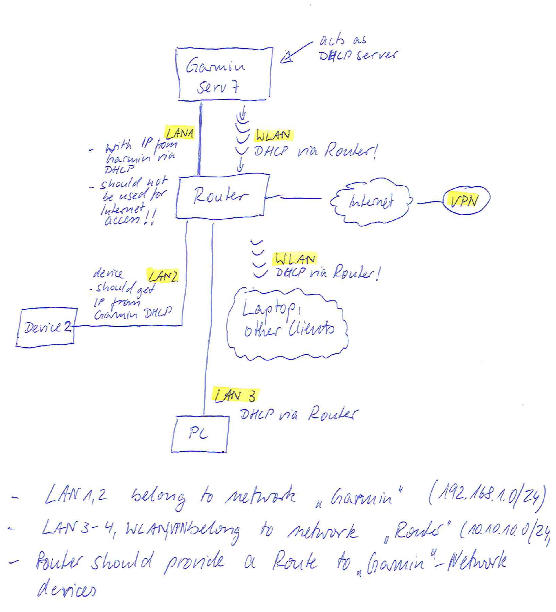

Sorry that it has been unclear. I try to clarify: I have a Garmin SERV 7 which together with a Garmin WDU manages the smart motorhome. They are connected via LAN. One of them acts as a DHCP Server and connects to Victron Cerbo GX, again via LAN. I can connect to them via LAN (but no DHCP Server must be active then in this LAN). I can connect them via WLAN to the Teltonika router, then if I connect to the Garmin via WLAN they route the internet via static route through the Teltonika router. Now I want to connect the Teltonika router to the Garmin network - either via LAN or WLAN, but not use this connection as internet connection - I just need this connection to manage the Garmin devices via VPN.
And the router should connect to a campsite network.
Garmin —-> Teltonika —-> SIM Internet
Garmin —> Teltonika —> Campsite Internet through WLAN
Garmin <— Teltonika to enable remote management of the Garmin system
I hope this clarifies what I want to achieve?

Hello Vilius, thanks a lot for stepping in and helping me with that. Please see the attached image for the network topology. I hope everything is clear with the image?
Thanks a lot for your help in advance! Best, André
