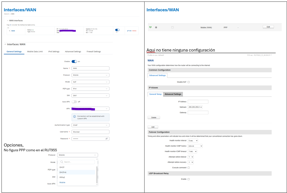

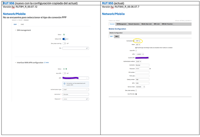

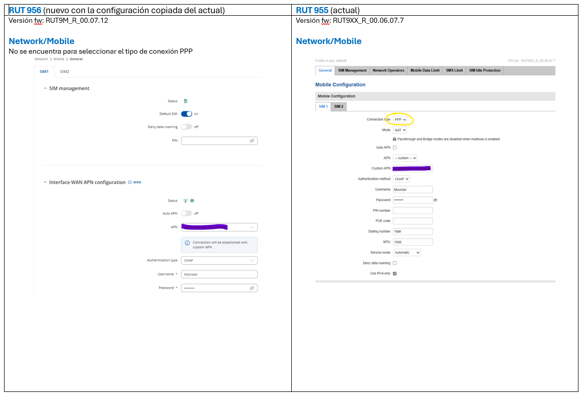

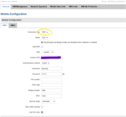

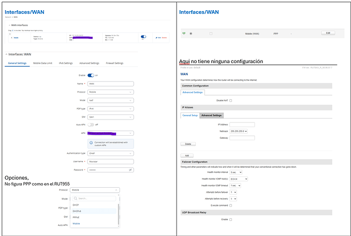

I need to switch from a RUT955 router to a RUT956, but the mobile configuration on the RUT956 does not allow a PPP connection. The RUT955 has this configuration with a private APN. How can I set it up on a RUT956?

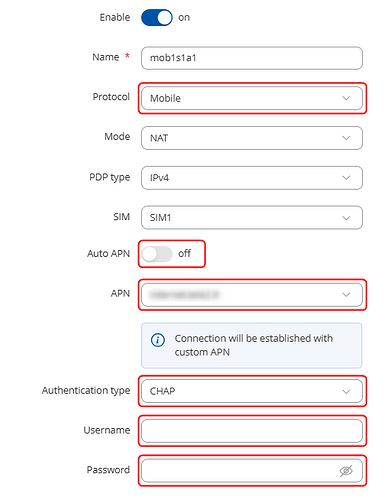

To set up this mobile configuration with a custom private APN on the RUT956, select the protocol as Mobile, then choose and specify the necessary parameters as shown in the screenshot below:

Thank you for your reply.

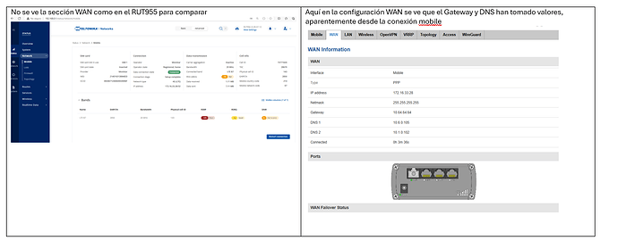

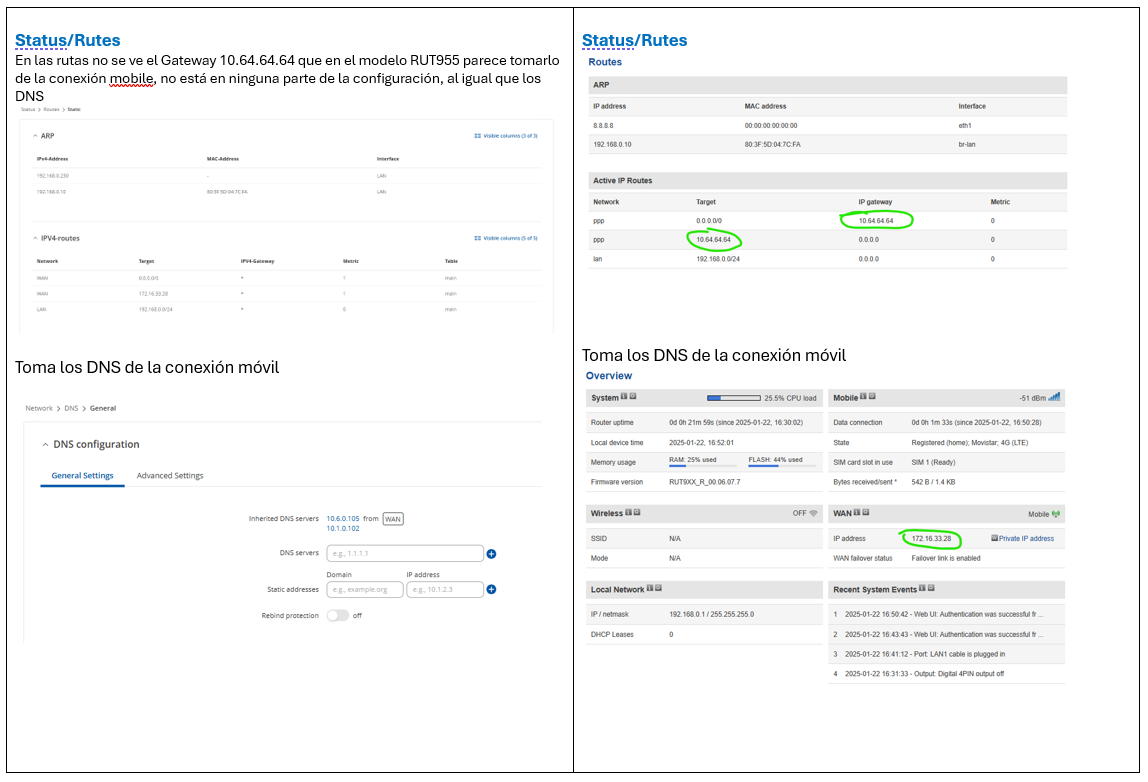

We have tried this configuration but we were unable to complete the communications. It sends data to the server, but there are update services that do not work.
We noticed that with this configuration it does not take the data from the mobile network gateway.
