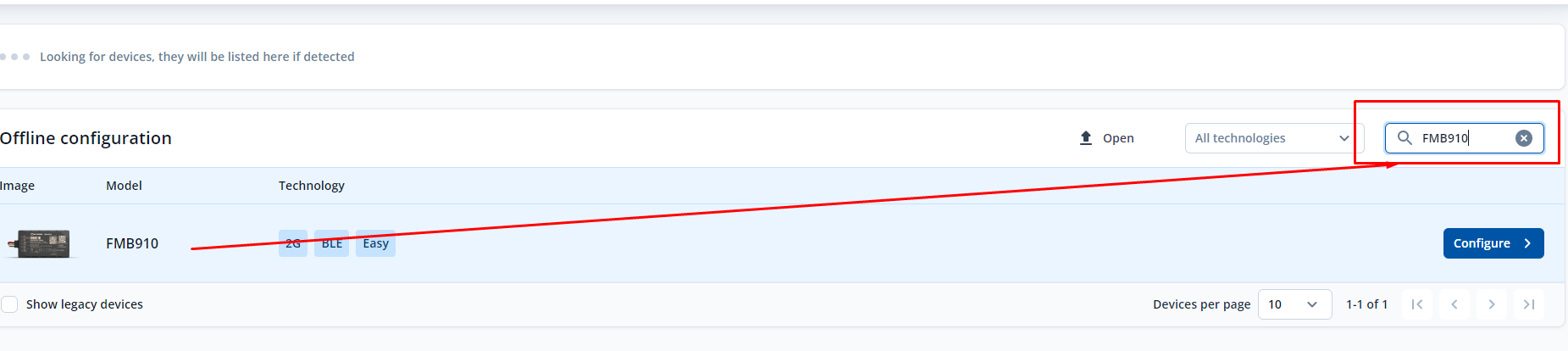

Unfortunately i am facing the same problem with this configurator and the problem is only with FMB910 devices. I am able to create configurations for all other devices.
One thing that i have noticed is that when i search for FMB910 the picture of the associated hardware is different. It seems like a bug in the configurator that is being carry forwarded
