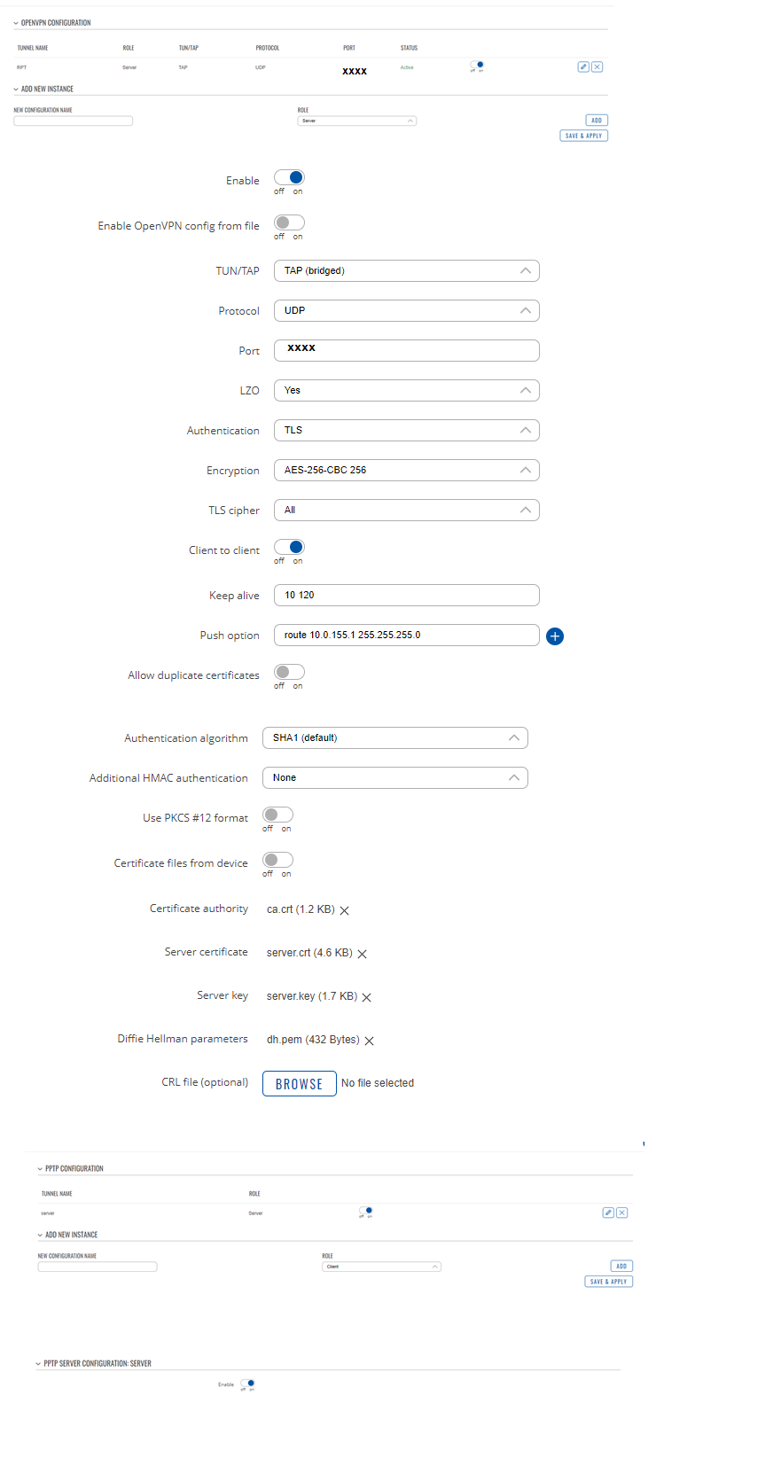

tengo un problema de configuración en el teltonika RUT950, se ha configurados dos tipos de VPN, una PPTP y la otra OPENVPN, solo me permite visualizar los host que están en la PPTP; en ocasiones permite ver los equipos de la VPN OPENVPN.

Could you please share your PPTP and OpenVPN configurations? Before sharing any information here, make sure to hide any sensitive information such as public IP addresses, keys, etc.
It would be great if you could share a routing table too. For this, connect to the device via CLI/SSH (instructions here) with username ‘root’ and execute the following command:
route -n
Buen día
Cordial saludo
Me permito enviar configuraciones.

First thing is that it seems like the memory is full. What packages do you have installed? What is the RAM and Flash use in Status → System → Memory? Could you please try deleting some packages that you do not use?
From routes, I do not see anything related to OpenVPN. Is OpenVPN client connected? You can check OpenVPN logs via this command:
logread | grep openvpn
