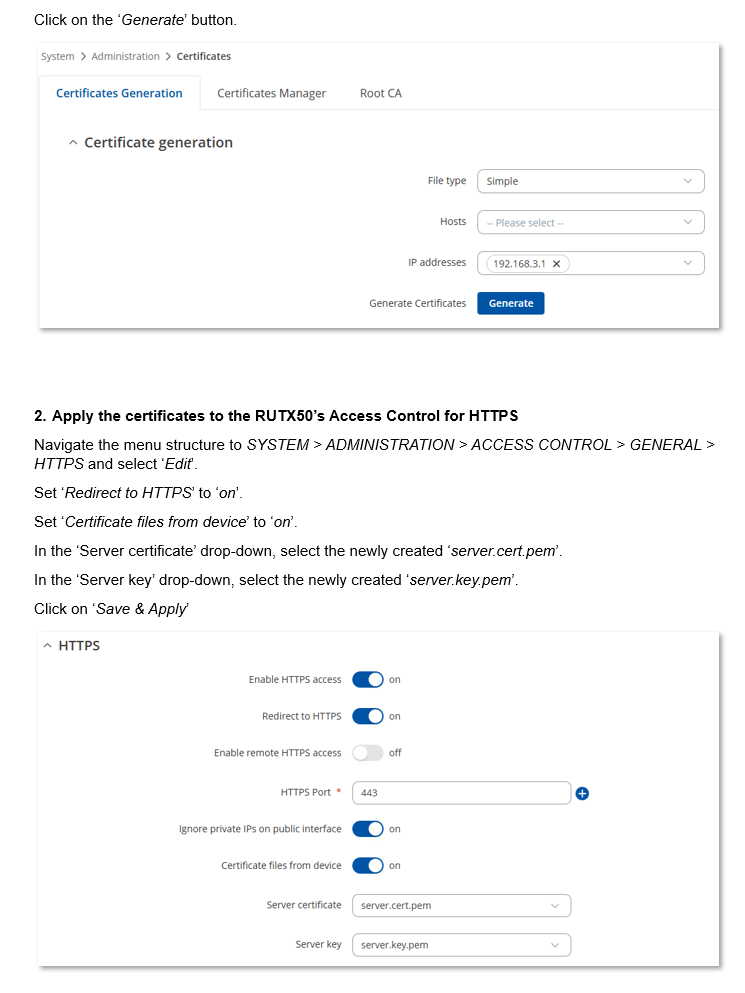

Here’s the ‘Bluffer’s Guide’ …
You can then export the CA certificate to your Windows PC by navigating the menu structure to SYSTEM > ADMINISTRATION > CERTIFICATES > CERTIFICATE MANAGER > CERTIFICATES and against ‘ca.cert.pem’ select ‘Export’.
Then import the certificate into your OS / Browser e.g. for Windows …
In the ‘Windows Search Box’, bottom-left of screen, search for ‘manage computer certificates’ and open the Control Panel ‘certlm’.
Select ‘Certificates’ under Local Computer > Trusted Root Certification Authorities, and go through the process of importing.
