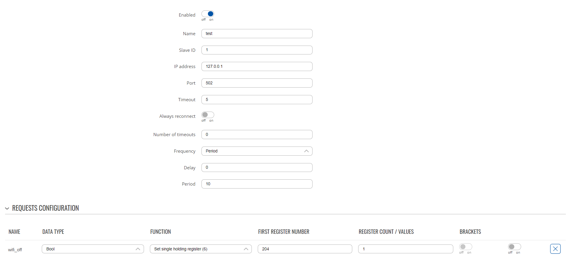

I’ve tested this functionality using the Modbus Master on the device, and everything seems to be working correctly. Could you try setting up Modbus Master using the following parameters:
Then press Save & Apply, re-open the instance and press the TEST button for the created configuration?
