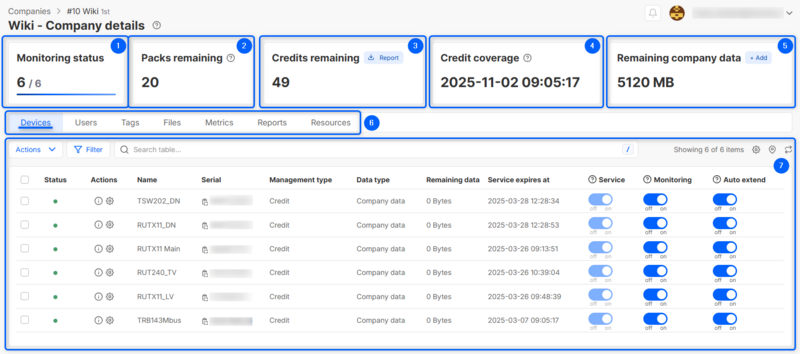

I presume your device is offline, and not your VPN Hub or whatever you had in mind. Devices need resources, such as credits or packs to be able to connect to the system, so ensure you have those first. This particular screen will show you how many resources you have, and what resources are assigned to your devices (Refer to points No.2, No.3, and No. 7 in the middle)
If you have resources, try re-registering the device (Management > Devices > Check the device > Actions > Devices > Unregister device), then just register it back.

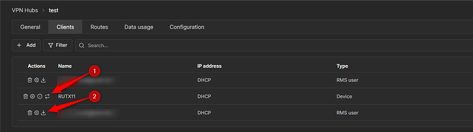

Regarding the Hub, you can also try re-pushing the certificates to the device (step 1) and downloading a fresh configuration file for your client (step 2), as shown in the screenshot below.

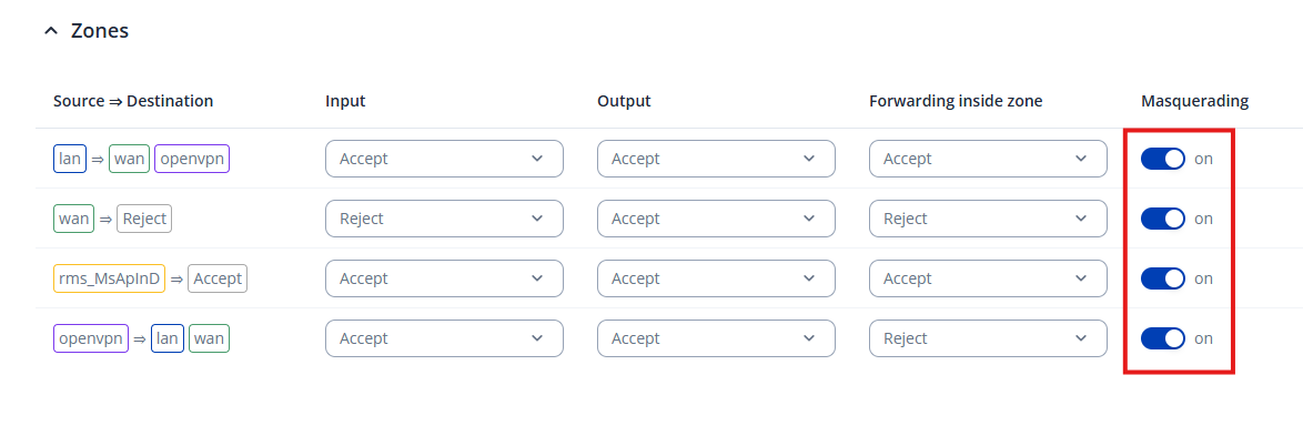

Additionally, check if the routes are set correctly and enable masquerading setting in Network → Firewall → Zones
