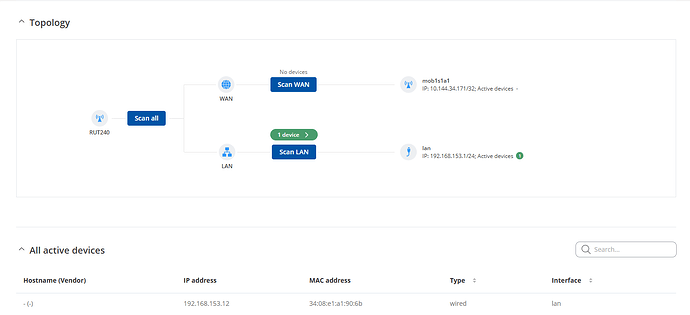

I have a RUT240 192.168.153.1 on site running the latest FW. I’m accessing this modem remotely using Zero Tier. The only device connected is a BMS controller using a static IP address 192.168.153.12. When i run a topology scan on the modem i can see the device connected onto the LAN port. But i am unable to connect to this device.

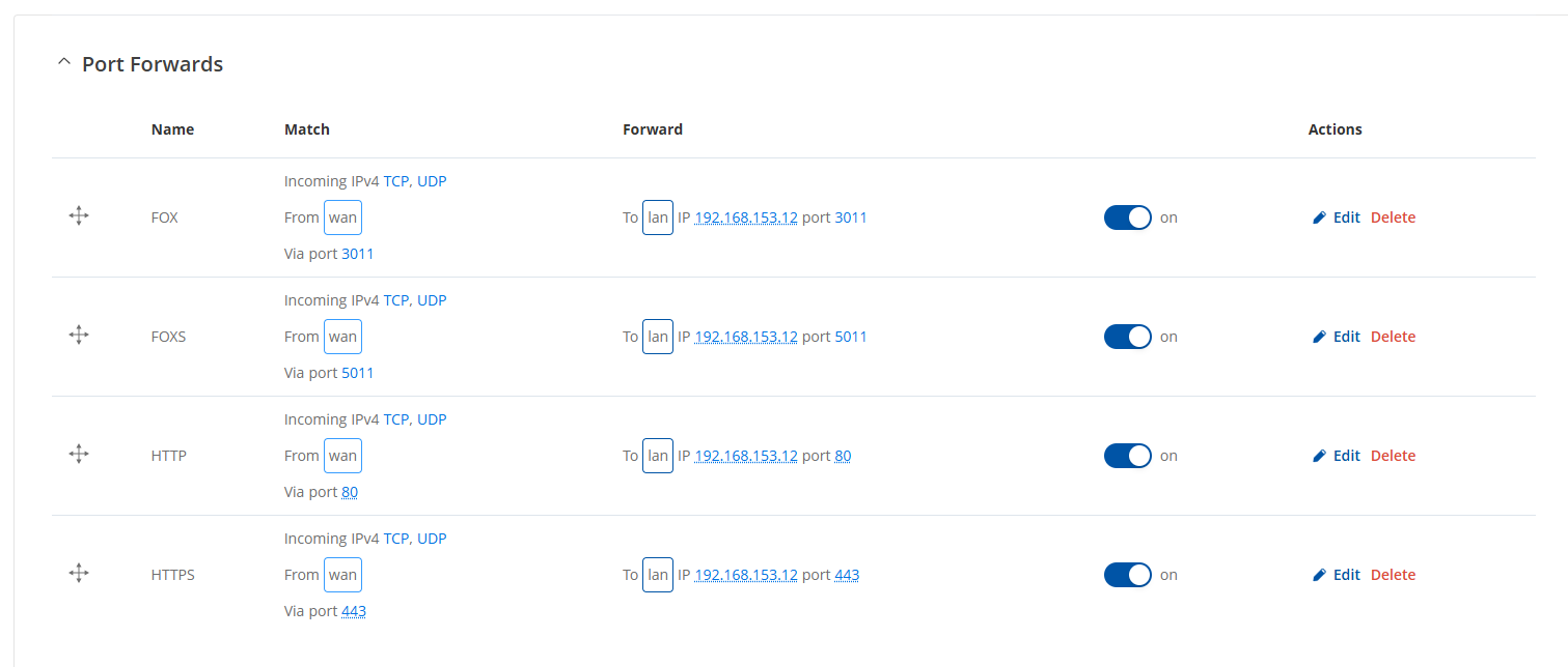

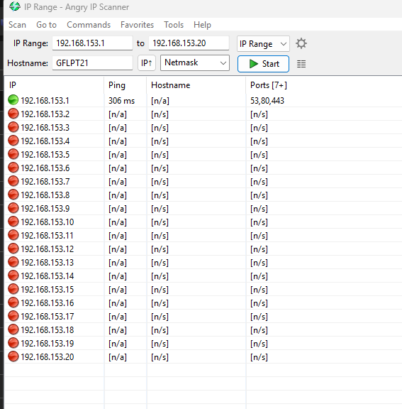

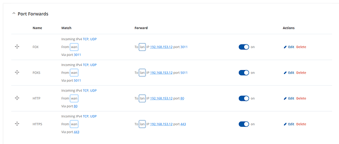

I’ve run advanced IP scanner and angry IP scanner but getting nothing back. I’ve also tried to open ports 3011,5011,443,80 and still no change.

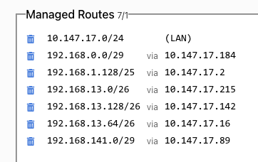

Do you have configured your routes at Zerotier?
Sample…
@Marcelo.Barros I have
