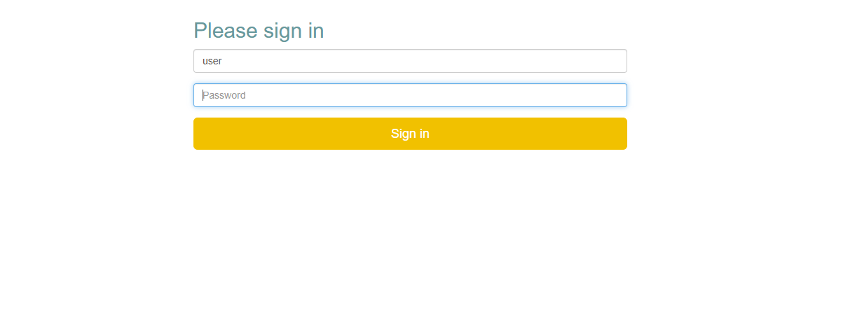

Hi, I have a TRB256 gateway and I can ping correctly the device with ping 192.168.1.1, I havent added a SIM card yet to the gateway, but it is connected via Ethernet to my PC. When I put 192.168.1.1 in a browser the following is showed.
It is different to the usual Teltonika Interface. I put the credentials of the device, but it says they are incorrect. I have tried also doing the factory reset, but it has not worked. Please, could you tell me what the issue could be. Thanks.
hum… This remember me a openwrt standard logon page..

The screenshot you provided looks different from the RutOS WebUI, which suggests that there might be another device on the 192.168.1.1 address. For TRB devices, the default IP address is 192.168.2.1. Please try accessing it using this address and let me know if you are able to open the WebUI.
