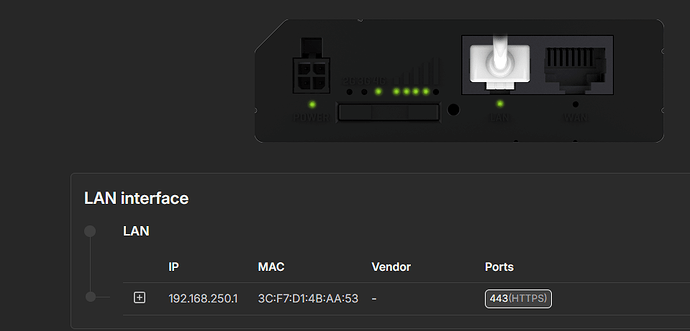

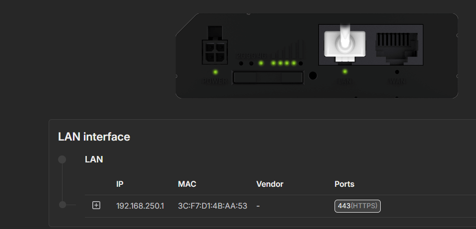

If i go to Devices → Device information → Ports, i can see that the cable is plugged in. I see when the cable is unplugged, but the IP of the PLC is not showing in the table below.
If i move the setup back to our office, suddenly i see the IP of the PLC.

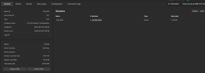

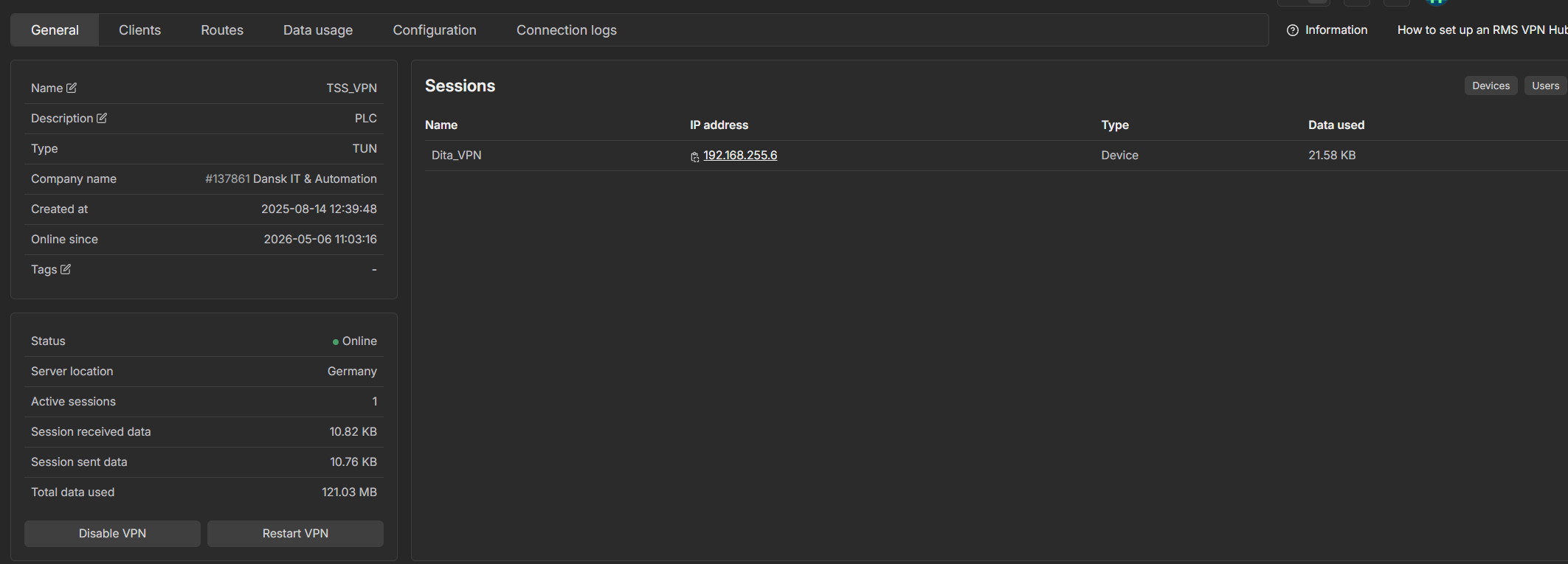

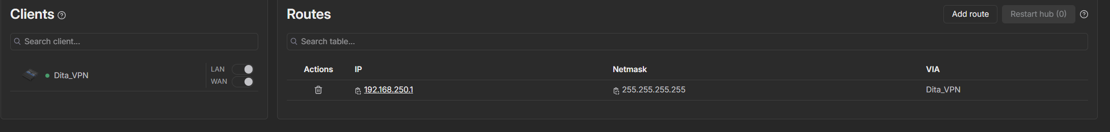

Could you please send screenshots of the VPN Hub configuration?
Also, make sure that the VPN Hub is set up according to the instructions provided here: RMS VPN Hubs - Teltonika Networks Wiki

We brought the router back to the office since it didnt work onstite. But when I checked Manegement → Devices → Device details → Ports I was not able to see the PLC when it was onsite. Now it shows, when I brought it back.
Screenshots of the configuration. This works when in the office. And also when I place it at another location aproxx 60km away. But not at the costumer.
