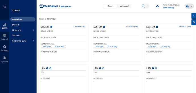

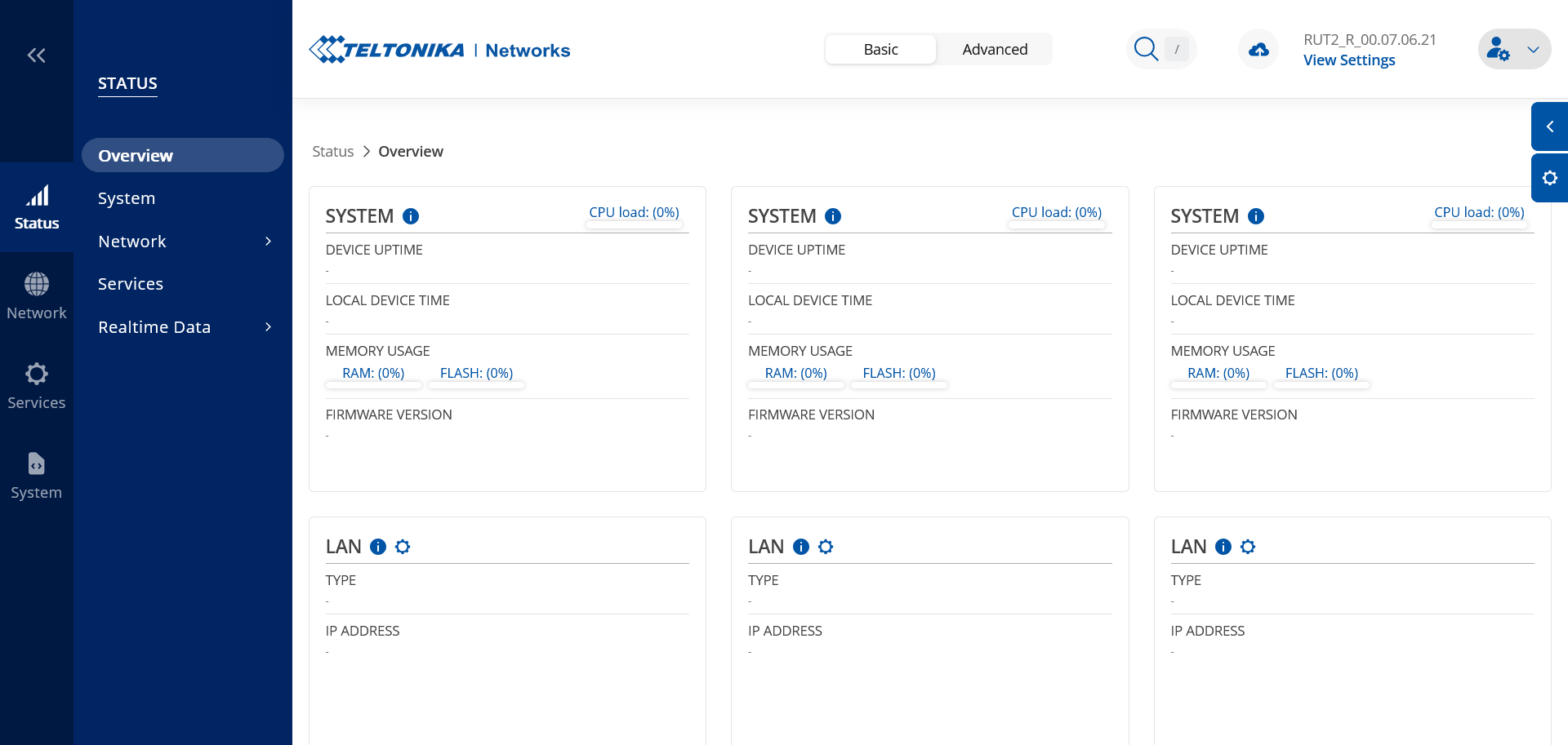

Have you try to clean the cache of your browser?
No progress…
That is my dashboard now
And like I said before…
If I try to run restore factory settings I see info about this process and after a minute the divice stops responding to ping and never come back (only bootloader flash option remains)
