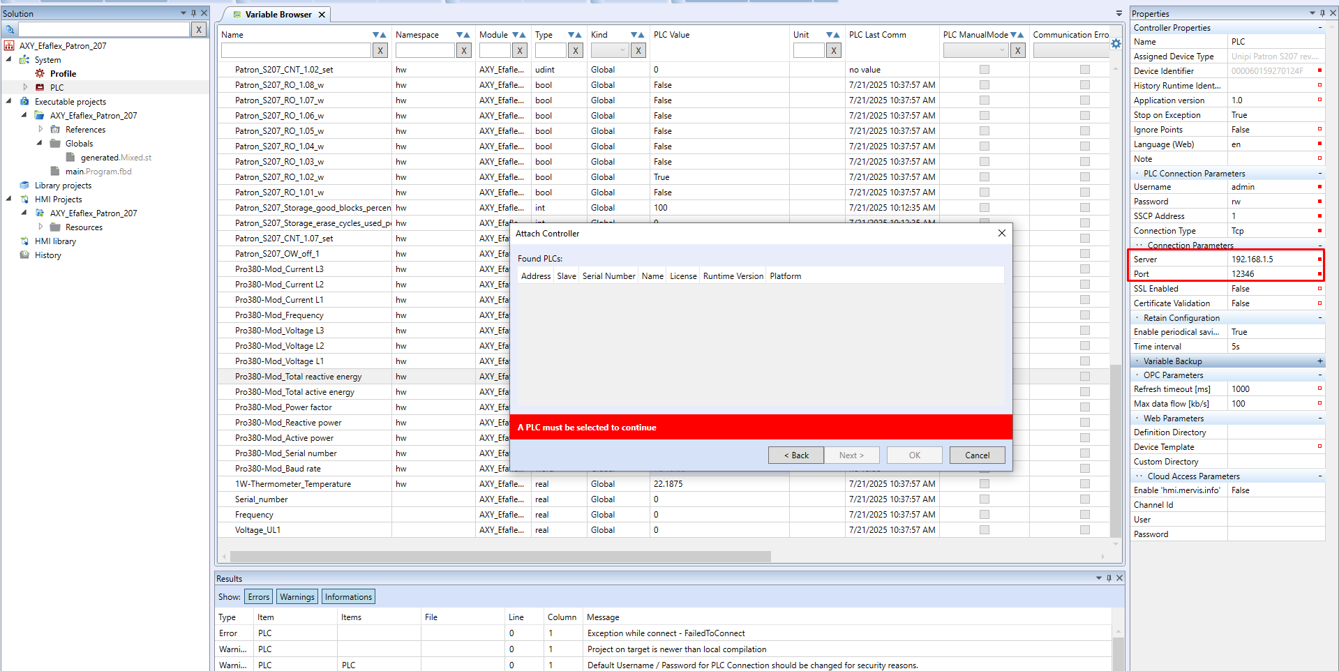

i want to connect to unipi PLC throught VPN. I am able to ping the PLC(.5) but the mervis IDE cannot find with UDP brodast.
I think it is firewall problem because when i connect straight to LAN it works fine.

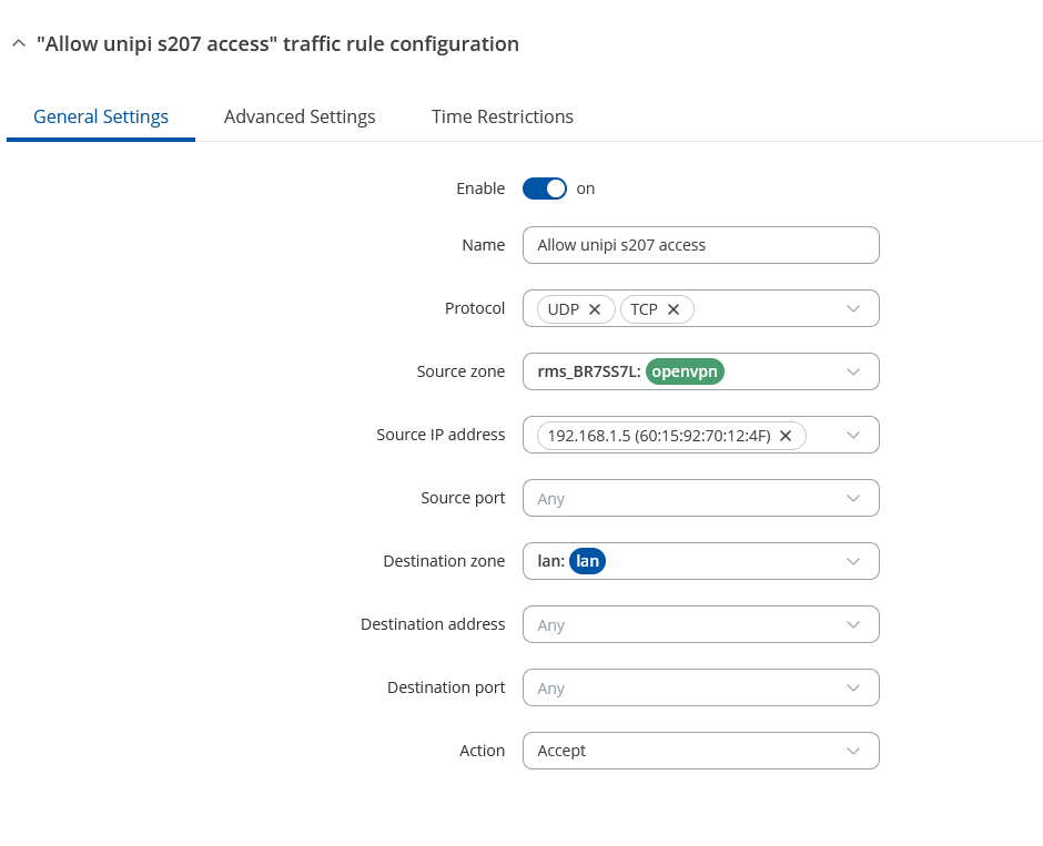

I tried to setup firewall rule but it didn’t works.

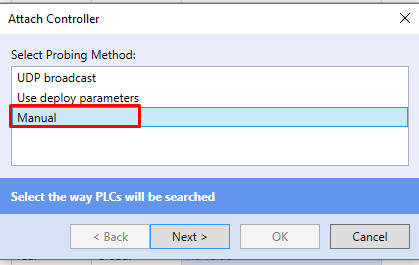

I used manual connection instead of UDP broadcast because brodcast didnt works on the VPN.

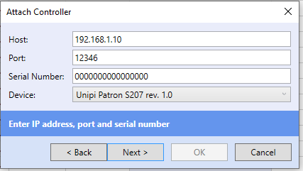

enter details about Unipi PLC.

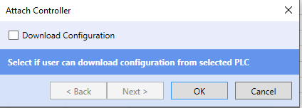

connected
