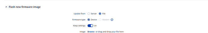

Greetings, @Wolfgang ,
Thank you for your message,
You can find and download firmware image here:
Simply download the firmware image to your PC, navigate to System → Firmware → Update Firmware in the WebUI, select update from File as shown in screenshot. And drag and drop the file. Once done, you should be able to update the firmware
I hope this helps,
Warm regards,
thanks for your link. I installed the latest version: TRB1_R_00.07.20_WEBUI.bin

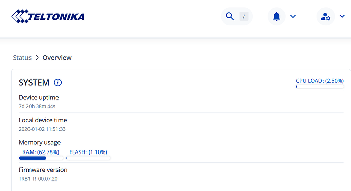

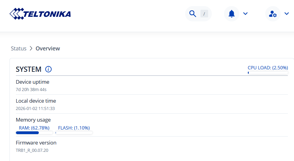

Hello Vilius, I wish you a happy new year!
Thanks for the hint to mbus_db. I have transferred the file to my PC and opened it with a SQLite viewer to check the data.
The directory /tmp/run/mbus_db shows only one file (4 MB) with the following data:
-rwxrwx— 1 mbus_cli mbus_cli 4194304 Jan 2 11:33 mbus_db*
What I am wonderring is, is there a limitation in the size of this file and / or the number of mbus_db* files which are generated by TRB143? If yes, can this be changed by the user? With current size of mbus_db file, measurement data of the connected M-Bus slaves can be stored for only a short period of time.
Your last community entry implies to me that the flash memory could be exhausted (at some point im time), but with current settings only 1.1 % is used, see following screen shot.
Greetings
Wolfgang
Greetings, @Wolfgang,
Thank you for your message.
Thank you as well, and I wish you a Happy New Year!
If you use a script that reads data from the mbus_db file and stores it in another file located in the device’s flash memory, then yes - over time, it may eventually reach the flash memory limits. To avoid this, appropriate file size management or rotation logic would need to be implemented.
Regarding the exact size limitations and best practices in this scenario, I will consult our R&D team to obtain a precise and reliable answer. I will update you as soon as I receive further information from them.

Hello, @Wolfgang,
It is possible to have multiple mbus_db files on the gateway; however, this would require manual management. For example, once the file reaches its limit, you could rename it (e.g., to mbus_db.old), create a new mbus_db file, and then restart the M-Bus service to continue data collection.
Regarding file size limitations, these cannot be configured. The mbus_db file has a hardcoded limit of 1024 entries, with each page being 4 KB in size.
I hope this answers your question. Please let me know if you need any further clarification.
