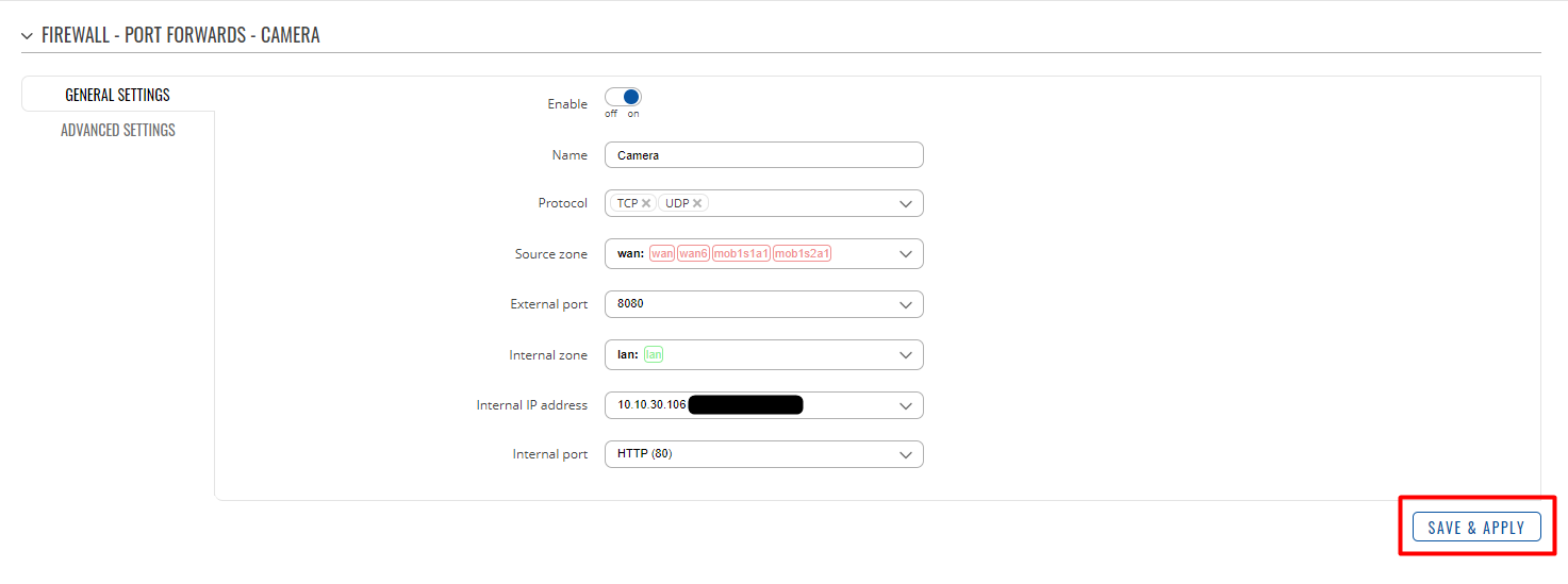

When I am testing port forwarding, I check first if I can reach the end device locally. Then, I configure the port forwarding rule on the router. It should be something similar to this:
Hope this helps!

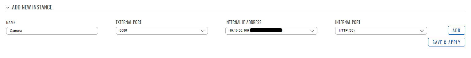

Thanks for the advice. I did my settings similar to what you entered but still cannot access camera. Is there a way to check on modem if camera is connected? I know that the camera is plugged into modem (port 1) but not sure if there is a way to check if camera is functioning, or if I have a setting in modem set incorrectly.
