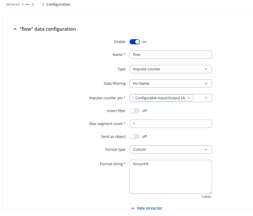

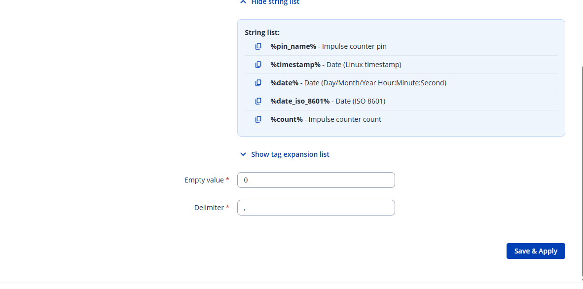

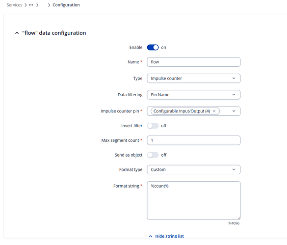

Could you please send screenshots of your data to server configuration? Please ensure that no sensitive information is included.

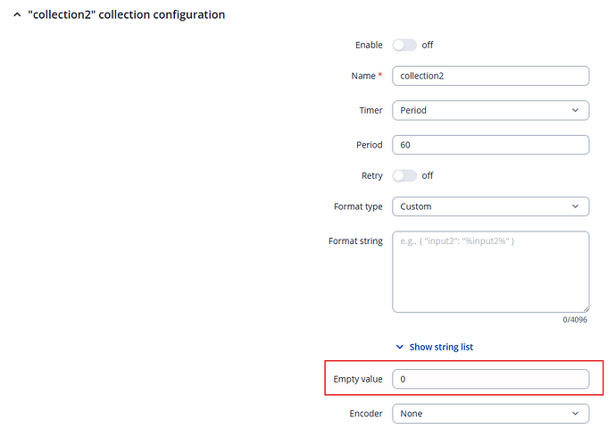

Also, have you tried setting the Empty value option under the collection configuration to 0 ?
Hi, thank you for the quick response. Sure, here I provide the data to server configuration. The zero is never sent.
As I said previously, the data to server works when the count is positive.
