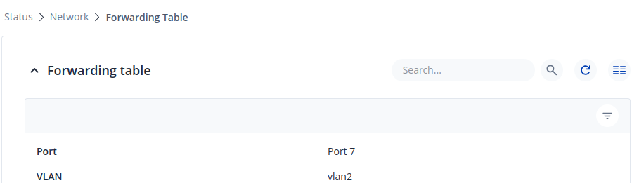

I would like to submit an minor bug in TSW212 fw. TSW2_R_00.01.09.1.
When adding an VLAN you give it name and VLAN ID e.g:
However in /etc/config/network it is given vlan2 name:
config bridge-vlan 'vlan2'
	option device 'br0'
	option name 'MGMT'
	option vlan '50'
	list ports 'port7:u'
	list ports 'port8:u'
	list ports 'sfp1:t'
	list ports 'sfp2:t'
Normally it would not be a problem however in WebUI under Status→Network→Forawrding Tableit gives vlan2 as VLAN not MGMT or 50. Hence it is very misleading during troubleshooting.
Hello!
Thank you for sharing this with us.
We have forwarded your report to our RnD team and will let you know of any updates once we have them!
Laura.
Thank you for sharing your feedback and drawing our attention to this situation.
Our RnD team agrees that improvements here are needed.
More information about VLAN will become available in one of the future firmware releases.
Whilst we cannot promise an ETA for the change, you can rest assured that it has been brought to our attention.
Laura.
