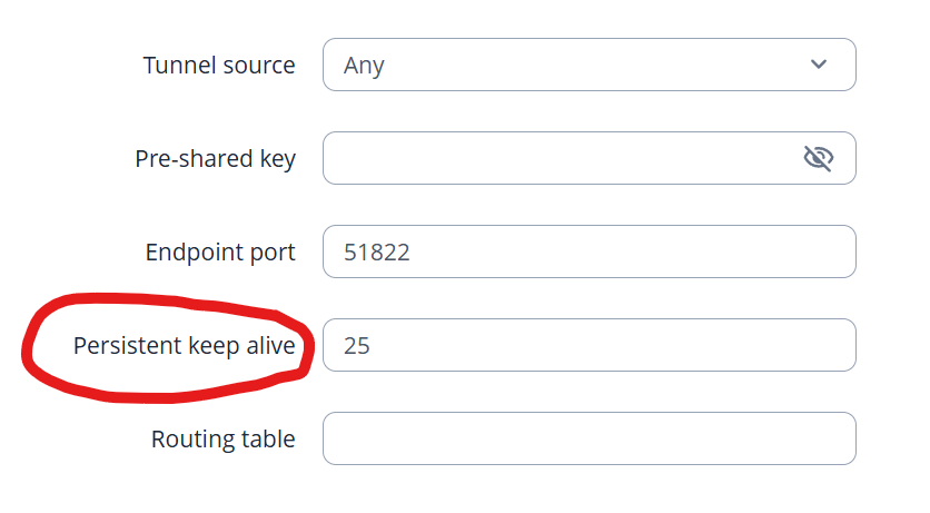

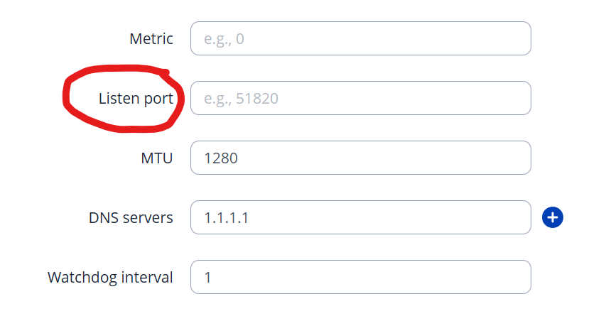

In order for the Wireguard Watchdog to actively monitor and restart interfaces when necessary, you MUST have a keepalive set in your Peer’s settings. 25 seconds being recommended.

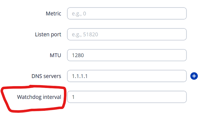

Also you need to place a value in the Interface’s Advanced Settings for the ‘Watchdog interval’ with 1 minute being recommended. I know that the helper says that ’if left blank’ it defaults to 1 minute but there has been a report that it DOES require an entry to function (yet to be verified).
Also some suggestions unrelated …..

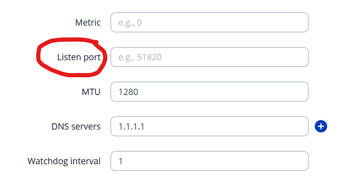

If your RUT241 is always the tunnel ‘initiator’, then it’s better NOT to have a listening port set on your interface.

I’ve applied all recommended changes:
  • Removed Listen port (now dynamic)
  • Set Watchdog interval to 1
  • Changed Allowed IPs to 0.0.0.0/1 + 128.0.0.0/1
  • Set Persistent keepalive to 25 seconds

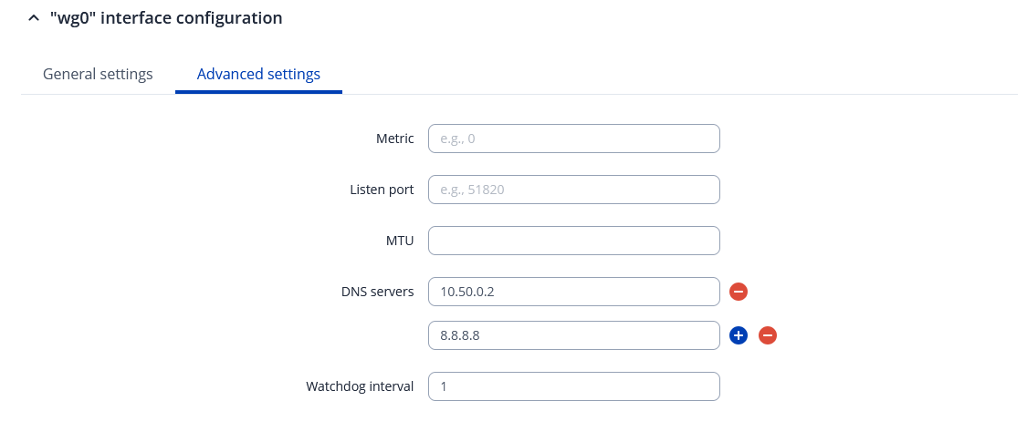

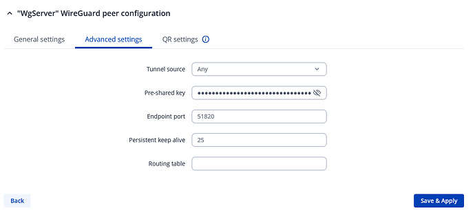

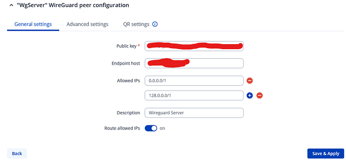

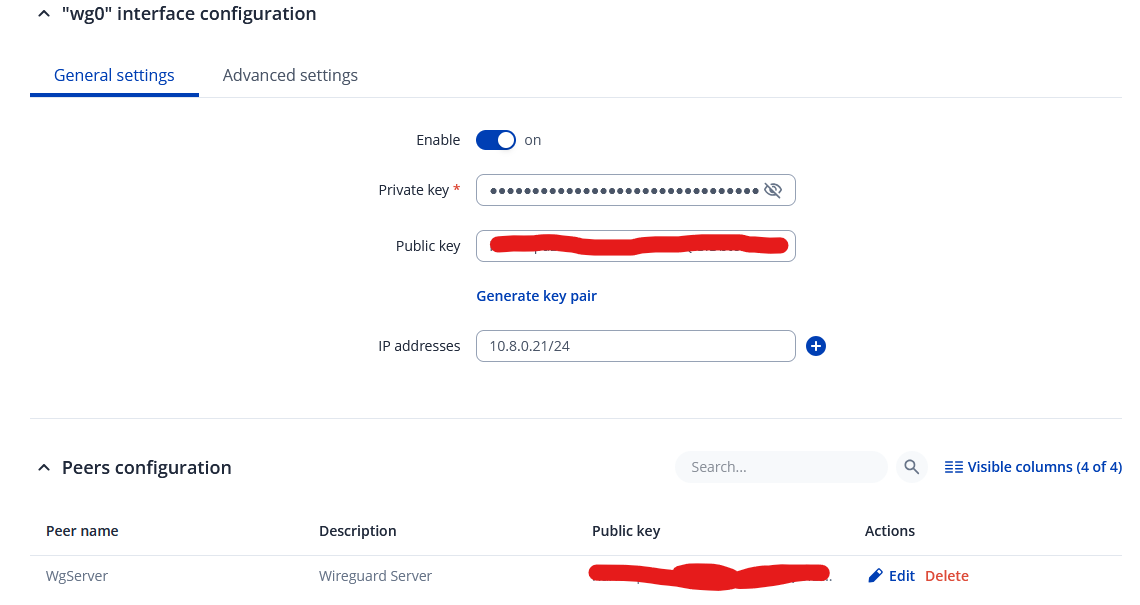

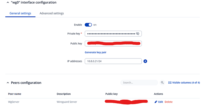

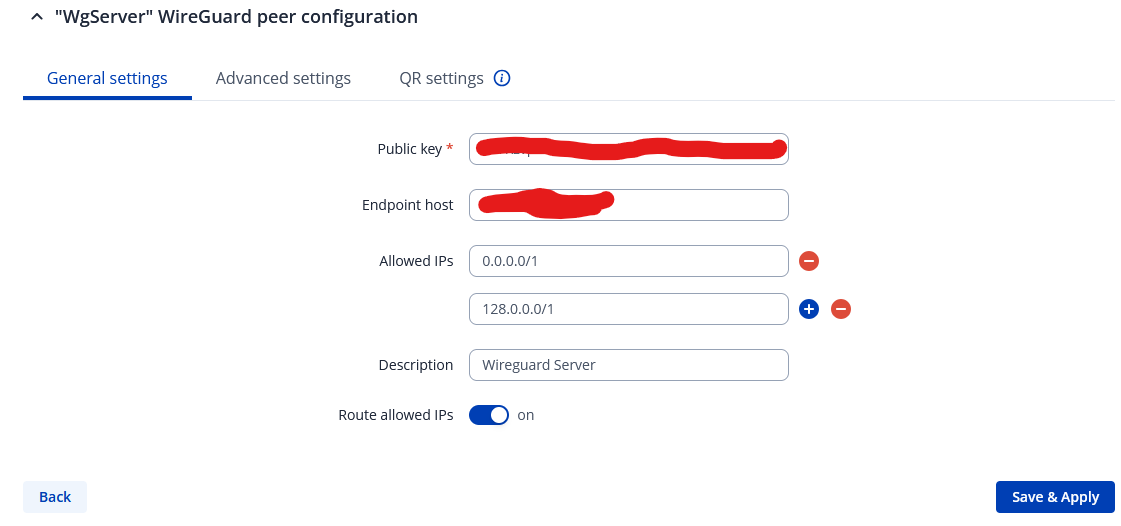

Screenshots of my current settings:
