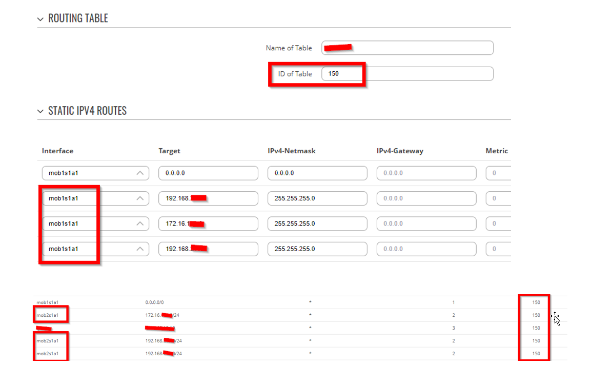

I have found that the edit view of advanced static routes table is not selectig the correct interface in the dropdown.
As shown in this example these routes should use interface “mob2s1a1” witch is correct in the view Status/Routes.
But in the edit view the interface inte dropdown is “mob1s1a1”.
Tested on SW RUTX_R_00.07.04.5 and RUTX_R_00.07.04.2
