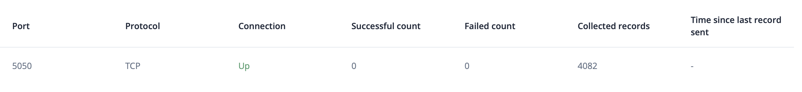

Hi! Again I’ve a problem with AVL. The last time, the host wouldn’t connect to the host (see AVL host not connecting anymore - #14 by NerdRelaxo ) now it doesn’t send any data to the AVL server, even it is connected. my Settings are unchanged since last time (see screenshots in the other thread).
The router has the following stats:
Time since last record sent stays “-” and successful count and failed count stay 0. Multiple reboots, power down/up and even a firmware update to RutOS 07.18.3 didn’t help.

Hi Vilius,
Yes, the rule is enabled. Also I didn’t change anything, it just stopped working from one day to another.
Yes, it collects data as the values increase. Also on the Map I get the correct location.
Yes, it is reachable, also per nc on the correct port.
Do I need to enable traffic log for this? In the eventlog I only find the configuration changes when I tried to fix it by changing settings.
Can’t do that while driving at the moment.
Yes I see the following logs:
