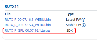

Either this or you can try building a custom SDK if you know what you’re doing. In the firmware download page of each one of our devices you should be able to find an SDK file for download. That file can be edited & later on compiled into a firmware file that can be then installed onto the device:
More information on how these can be edited & compiled can be found here: RUTOS Software Development Kit (SDK) Instruction - Teltonika Networks Wiki
