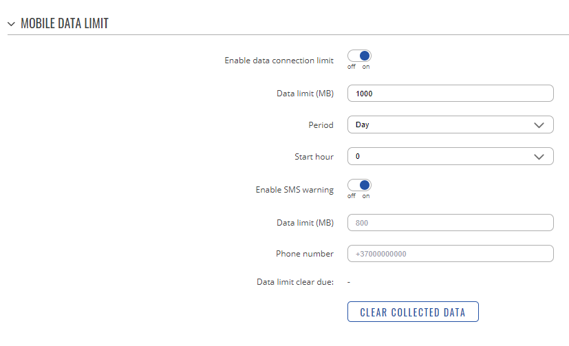

You can set the data limit and enable an SMS warning for it in Network → WAN → edit Mob1s1a1 → Mobile data limit section. When you activate the SMS warning, you have the option to define both the data limit and the threshold for sending the SMS warning. It’s important to note that you can configure only one SMS warning. For instance, if you set a total limit of 10GB, meaning the data connection will be restricted after reaching this limit until a reset period, you can also specify the device to send a warning when, for example, 8GB of data has been used.
More information is available here.
Above solution is not going to work.
You need to be able to configure the text. (Something like send “extend” to 1234)
