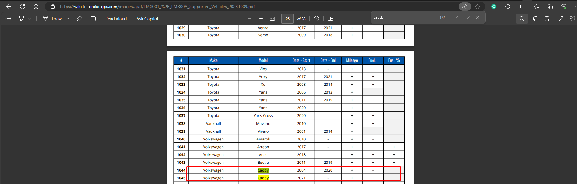

Based on our supported vehicle list we do support from the year 2004 up to 2021
!FMB003 supported vehicles v3.3.xlsx (teltonika-gps.com)
Make sure that your device firmware is updated.
Download the lastest firmware here: https://wiki.teltonika-gps.com/view/Special:Redirect/file/FMB.Ver.03.28.03.Rev.97_and_configurator.zip
Please make sure that the model of your vehicle is in the same year model that we have. If you still receive the wrong total mileage value please contact your sales manager or create a Helpdesk ticket. If you don’t have any contacts with our Sales managers, please contact them on our official website https://teltonika-gps.com/ and click on the “Contact Us” button. When you click, please fill out the form and submit it. Note: as a topic, please choose “Vehicle telematics”. Or you can send an e-mail with description of your situation to info@teltonika.lt When contacting Us, please provide: IMEI/Logs/Configuration file/Intenational GSM number/Firmware version/ect , please follow these recommendations: Recommendations for filling a query description - Wiki Knowledge Base | Teltonika GPS
