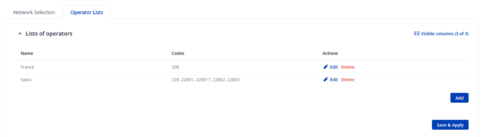

I want to block all Swiss networks, so I created a blocklist and added the Swiss networks.
(Network –> Mobile –> network selection)

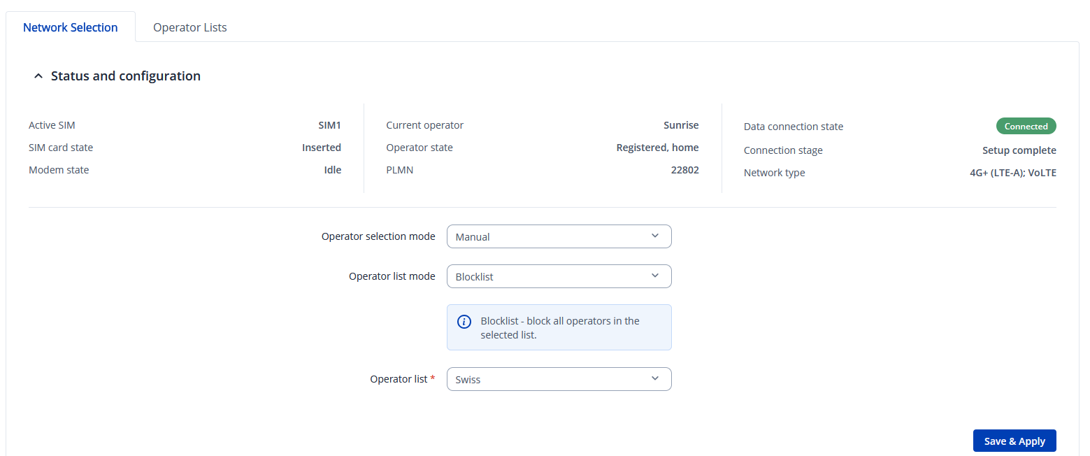

But the RUTX11 keeps connection to the Sunrise network.
The same issue occurs if i use a French allowlist, it still connects to Sunrise.
I am working on a RUTX11 with the firmware RUTX_R_00.07.19.4

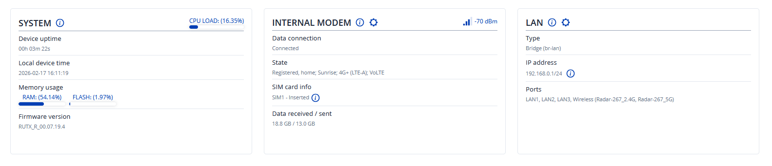

It still connects to Sunrise because it’s your SIM provider - home network. You can see that in Operator state field.
Allowlist/blocklist works only when you’re roaming or using non home provider.
