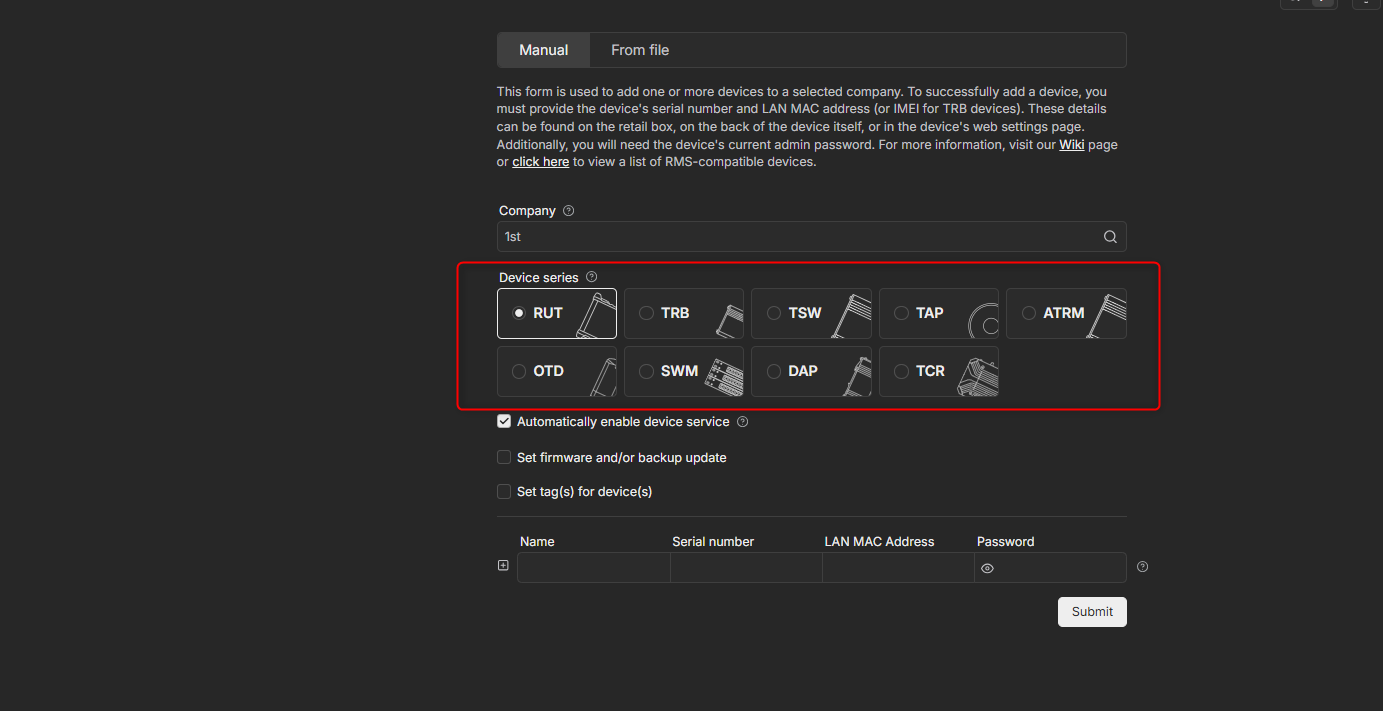

This classification directly corresponds to the Add Device section in the RMS web application, as shown below:
In this context, RUT951 is the device model, not the series. Therefore, it is not possible to set the series value to RUT951; the correct series selection would be RUT.
